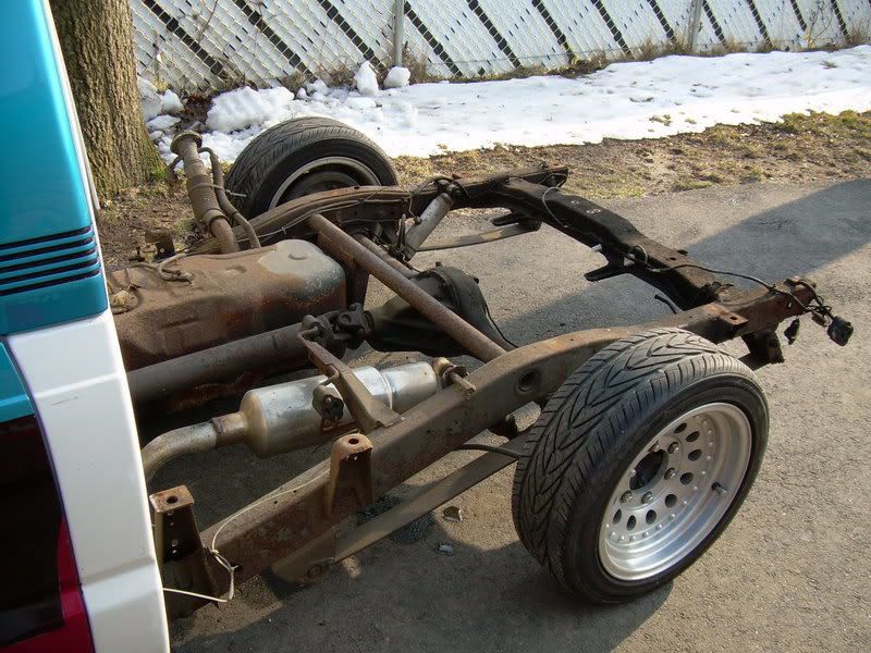

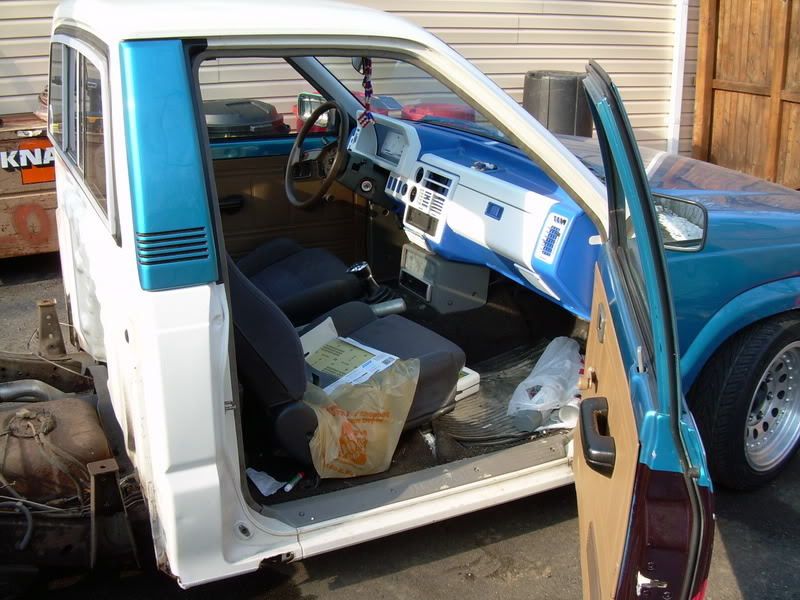

i%20took%20the%20bucket%20off%20so%20i%20can%20wet%20sand%20it%20standing%20dam%20back%20of%20mine.%20<!--%20s:o%20--><img%20src="{SMILIES_PATH}/icon_surprised.gif"%20alt=":o"%20title="Surprised"%20/><!--%20s:o%20-->://i158.photobucket.com/albums/t98/b22lvn/mazdapics038. i also went a little notty with the camera []://i158.photobucket.com/albums/t98/b22lvn/mazdapics026.jpg[/IMG]
ok i got carried away but its more of someone elses truck to look at enjoy.oh yea its popeyes play ://i158.photobucket.com/albums/t98/b22lvn/mazdapics036-1.[/IMG]://i158.photobucket.com/albums/t98/b22lvn/mazdapics035.
gotta love the old school guages...lol

that is some serious pinion angle on the rear (be careful of bearing &amp; pinion wear), &amp; the mono-leafs are bowed up.....are you running air shocks in the rear?

yea man i'd be afraid to drive that! Those springs can only take so much and it looks like there gonna let loose. The pinion angle on the rear will also eat u-joints and cause premature wear, Other then that it looks like a good project bro!

how many times a day does that rear axle hit the frame?
