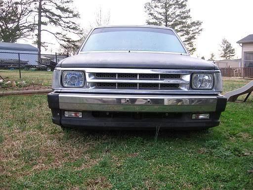

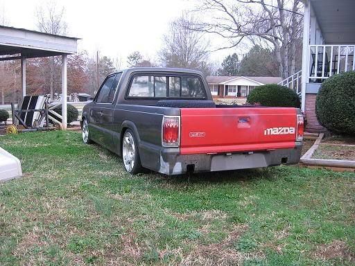

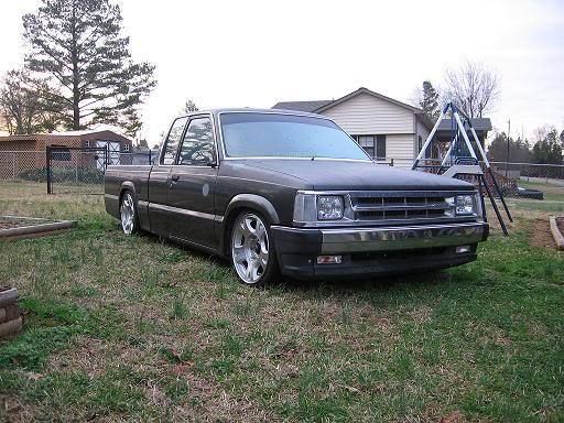

finally got the time to get the mazda lowered. here some spy photos. tell me whatcha think.
boon
looks good... perfect ride height

man, that looks real nice. how did you lower it?

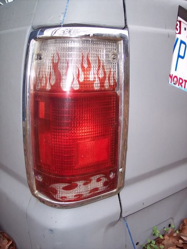

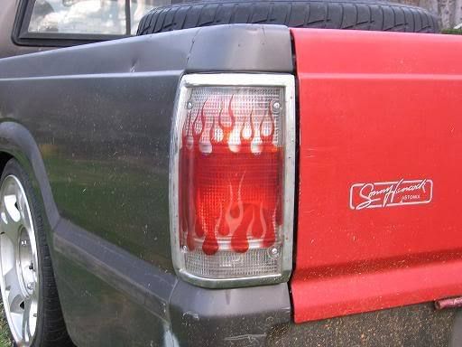

looks good, lik the tail lite flames, nice touch!

in the front i cut the bump stop mount out and both the upper and lower shock mounts off (preparing for the bags) and flipped the lower ball joint. in the rear i got 3" blocks and dearched leafs (mono leaf with the overload on top). hopefully in a few weeks im gonna cut the frame behind the cab and raise the whole rear clip 4" instead of doing a notch and take the blocks back out.

those tail lights are sick. sweet truck!

Pics look good! For a static, that would be about the right height. Interesting effect on the tail lights - I like.

nice taillights
