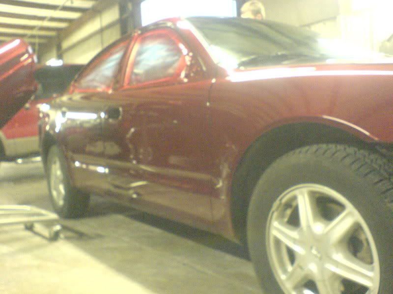

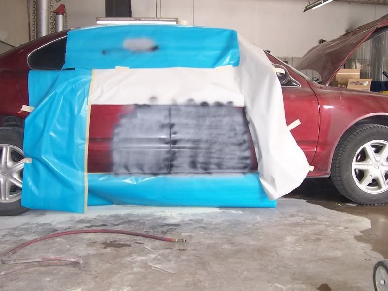

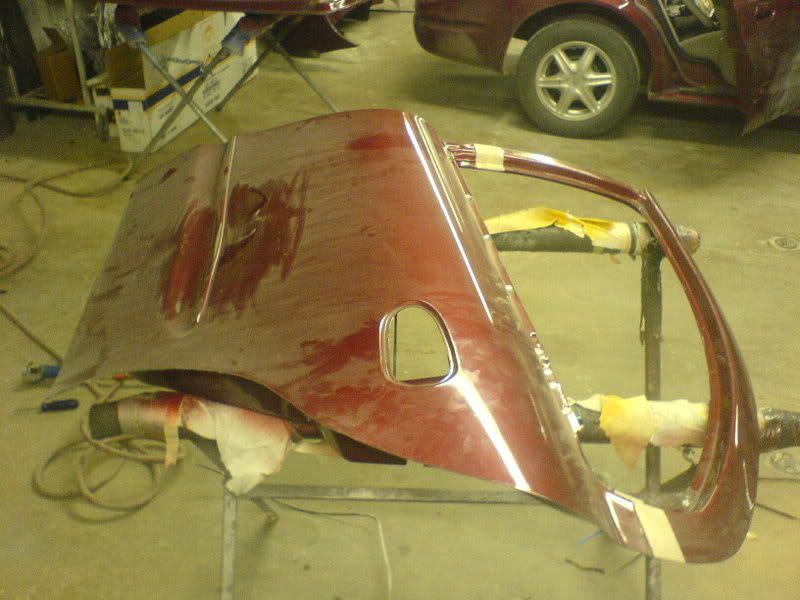

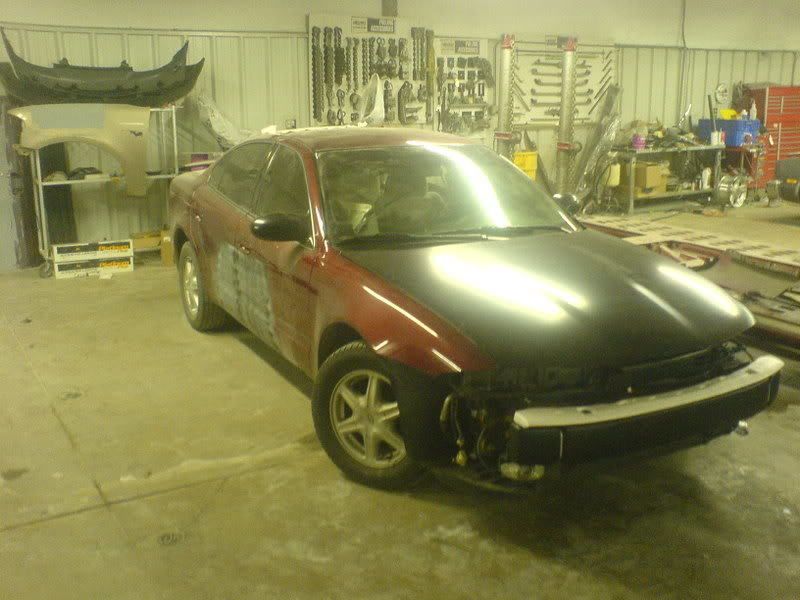

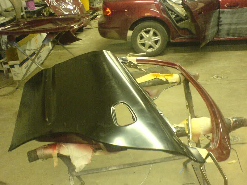

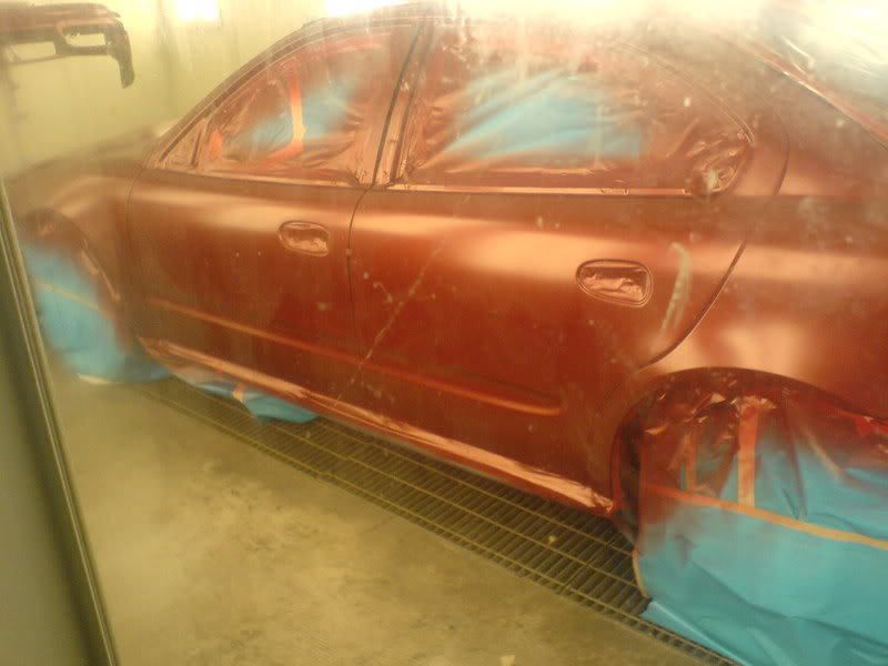

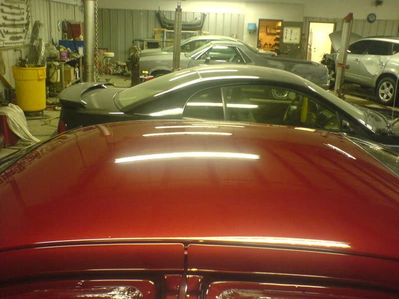

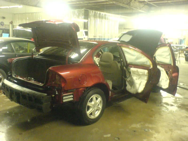

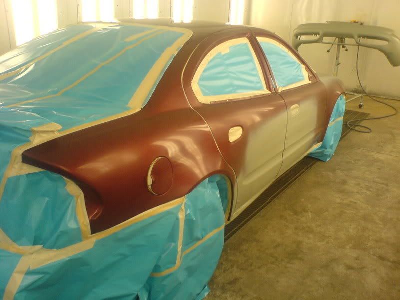

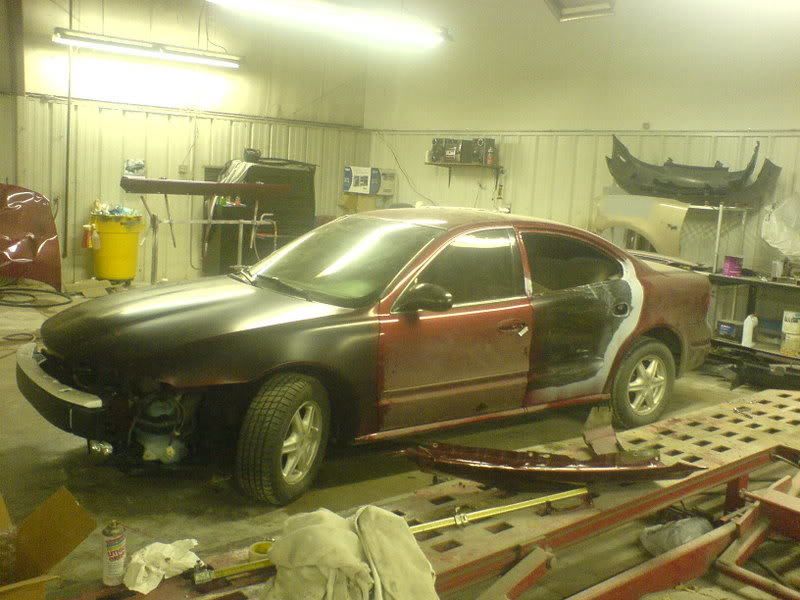

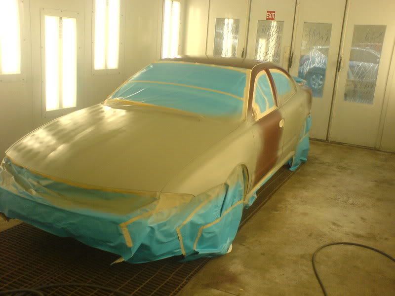

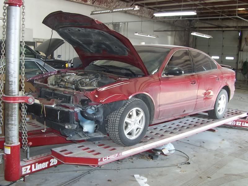

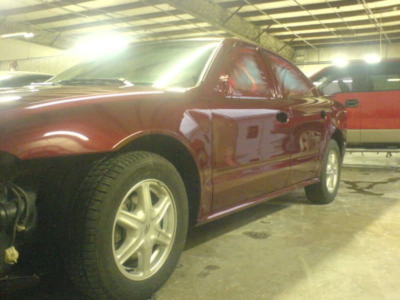

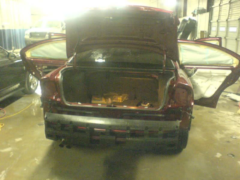

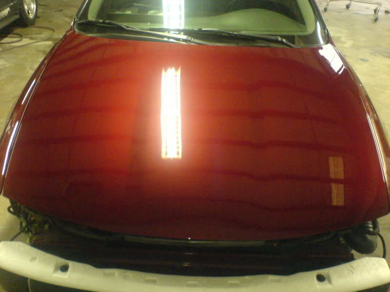

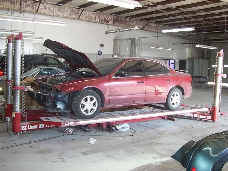

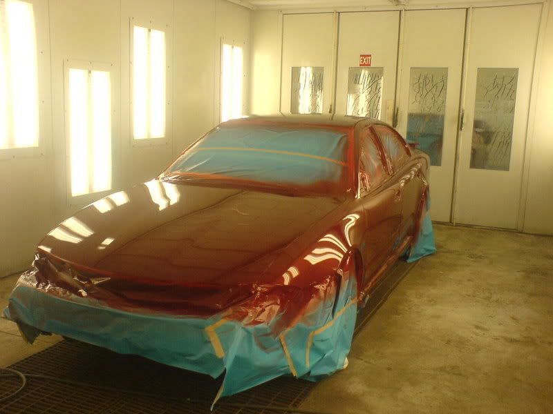

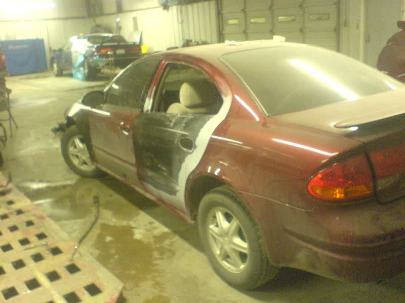

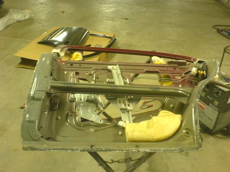

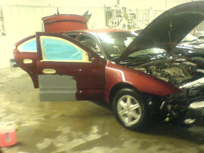

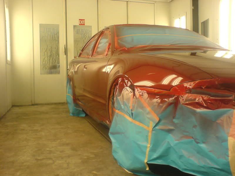

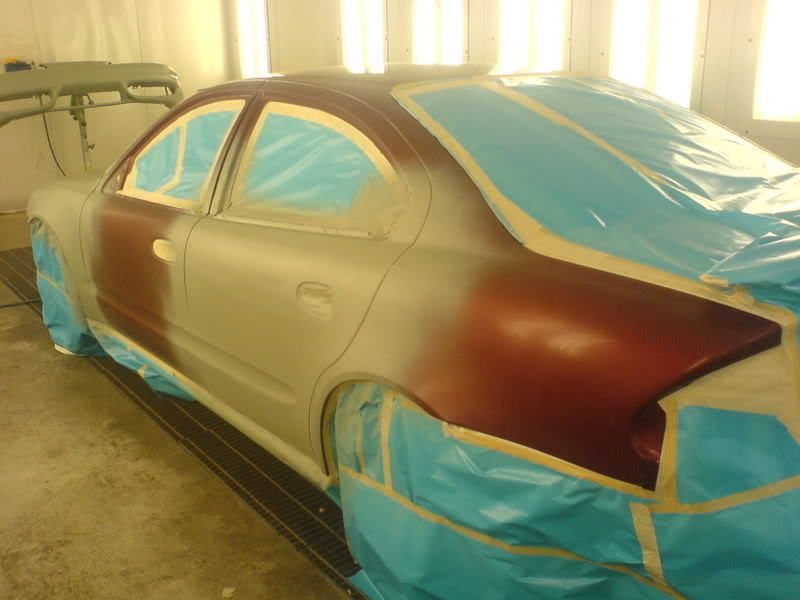

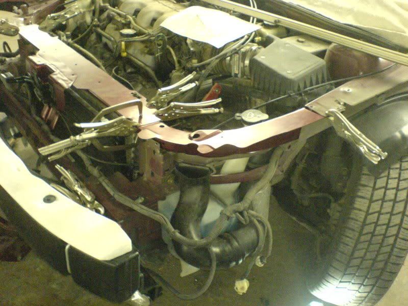

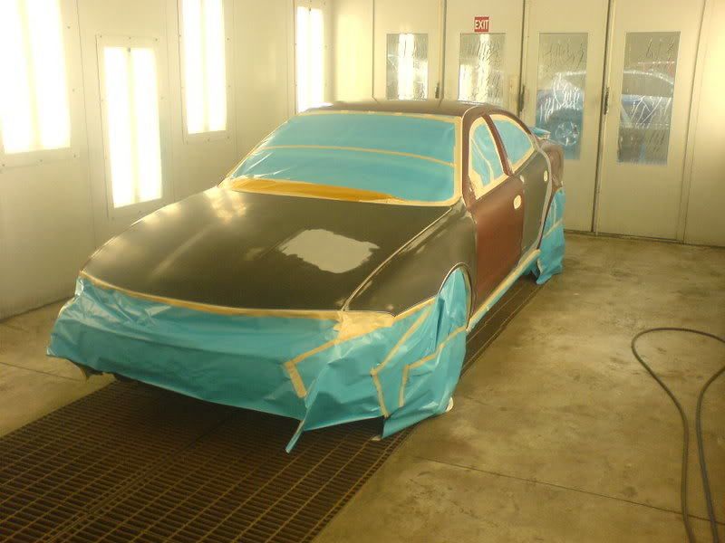

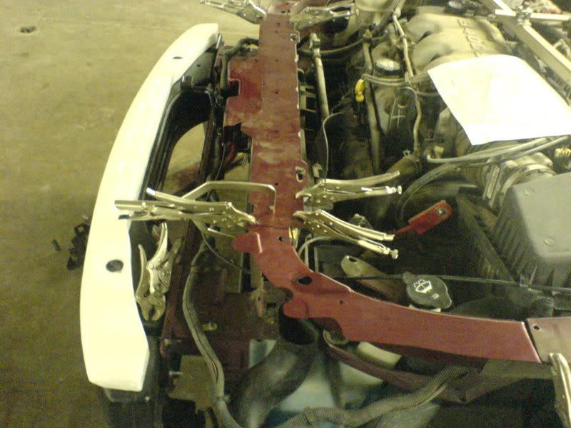

Its not a mazda but my girlfriend hit a deer and someone backed into her the same day. I skinned the rear diverside door, replaced part of the upper rail and upper radiator support, new hood, fender, and bumper. On the passenger side about a year ago someone hit her and ran off so I told her while it was in I would fix that. Painted the whole car minus the deck lid.

Nice job man, what did you use to install that door skin? Hammer & Dolley or that pneumatic skin tool?
robbie
hammer and dolly. I want to try the air hammer and door skin attachtment before I drop $300 on it.
