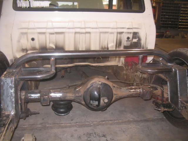

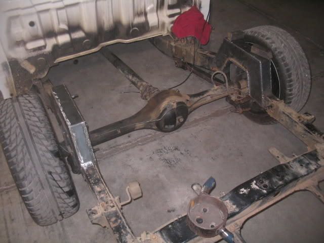

oldskewlkool

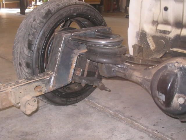

heres all the ass end pics
bagged2600's avatar
bagged2600
Nice. You have a very solid setup very cool!
scarecrow's avatar
scarecrow

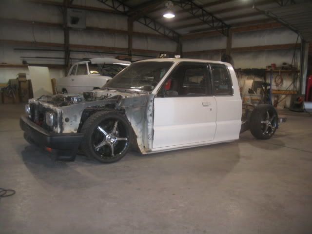

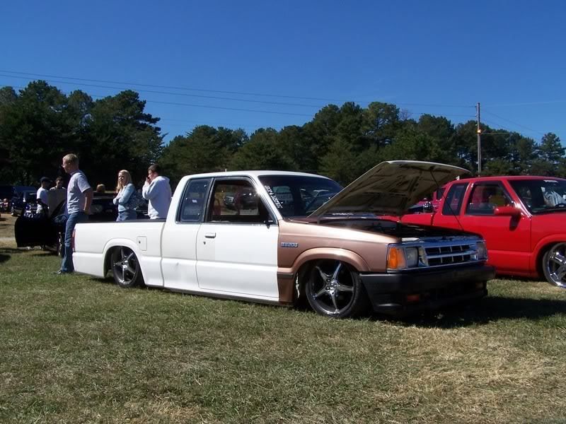

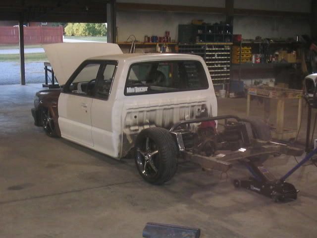

ok ok ok i want specs! what bags? what wheel size? what size tires? are those 4x4 fenders? ect... sweet set up though. it looks like an easier set up compared to the other routes i've thought of going.
oldskewlkool
the bags are 2500's up front 2600's out back, whels are KONIG Troubles 17" 215/40/17, all 2wd sheet metal, the setup up front is bags mounted over the upeer control arm, custom built lower controlls and AIM peice of mafuckin Shit spindles, REAR is a 2 link w/panhard bar, very simple,plain and clean, i left out very functional for a daily driven vehicle. all done in 3 days, bagged and 5 lug conversion!!! we were humpin ass
