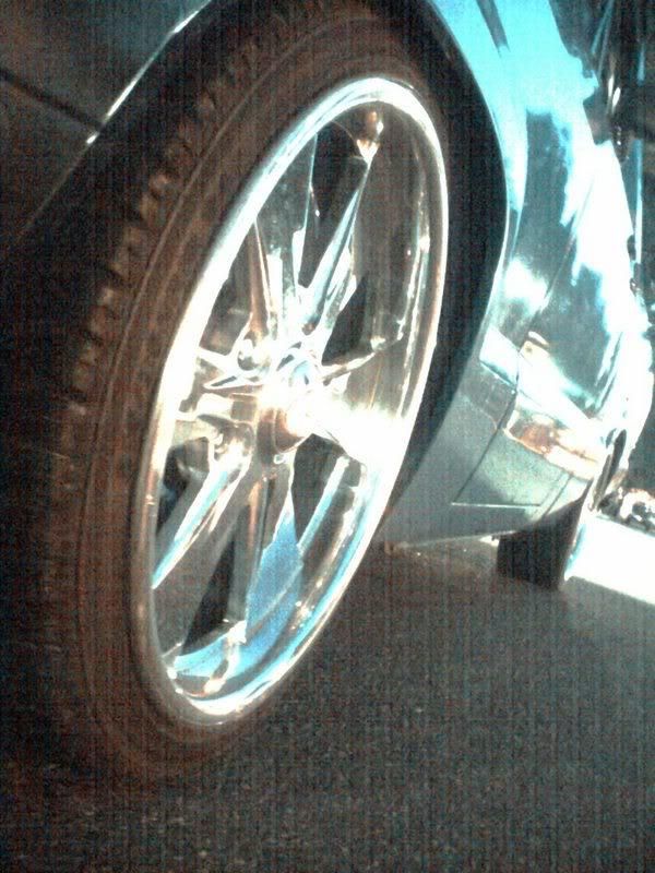

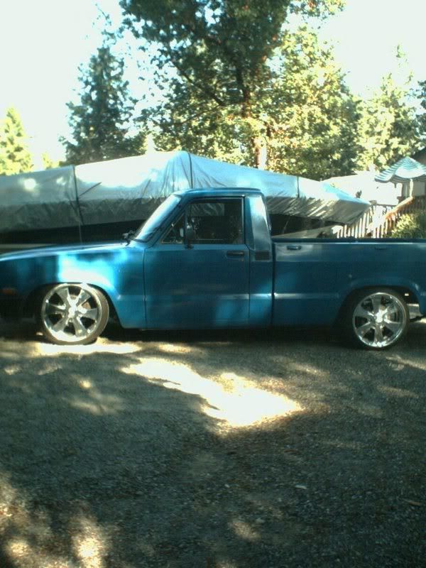

this one is on 18's with 225/40's...
225/40-18 equals 25.1"
215/35-18 equals 23.9"
roughly an inch difference, so it could go 1/2 inch lower and still have the same fender gap as it has now, plus it looks as if it could go about 1" lower now....
so the frame would end up being almost 2 inches lower than this one is (1/2 inch on bottom of tire and 1.5" suspension drop
