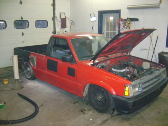

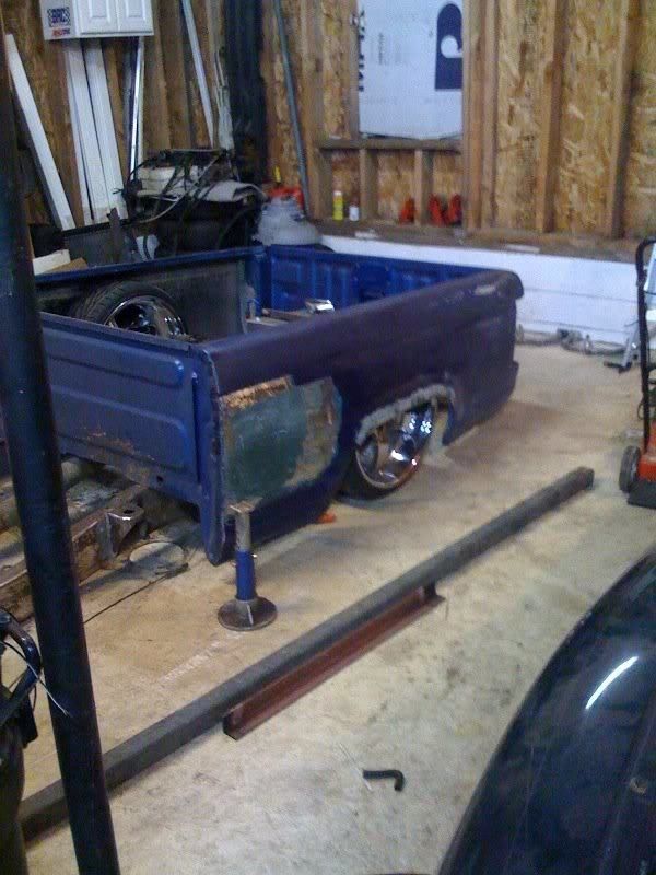

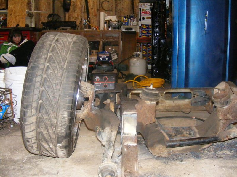

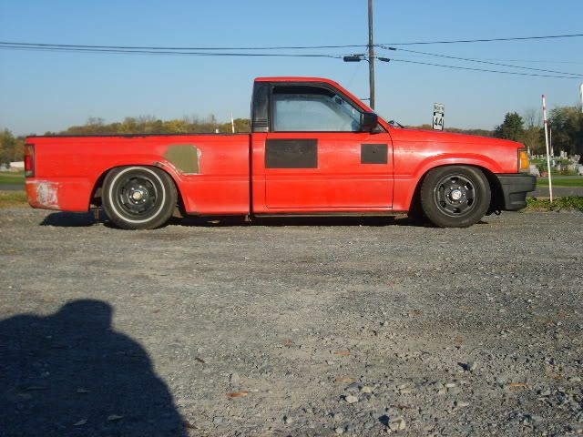

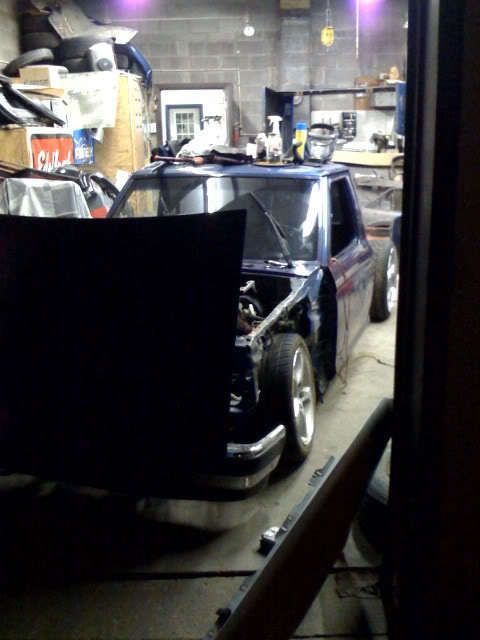

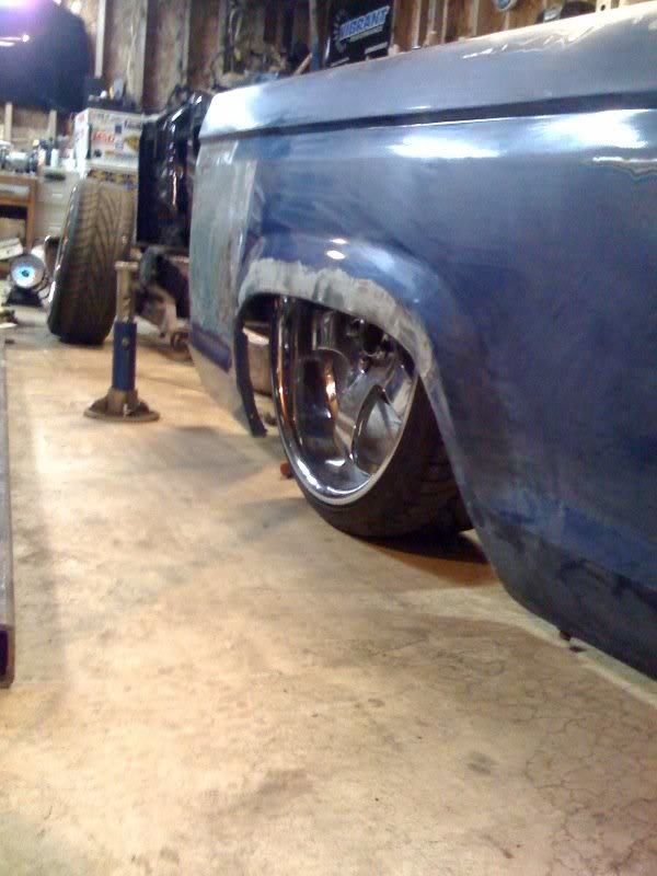

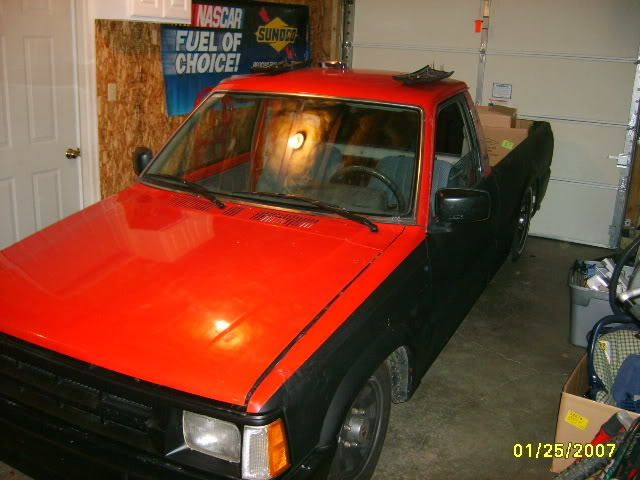

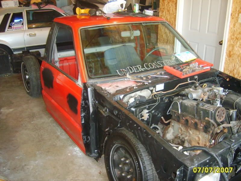

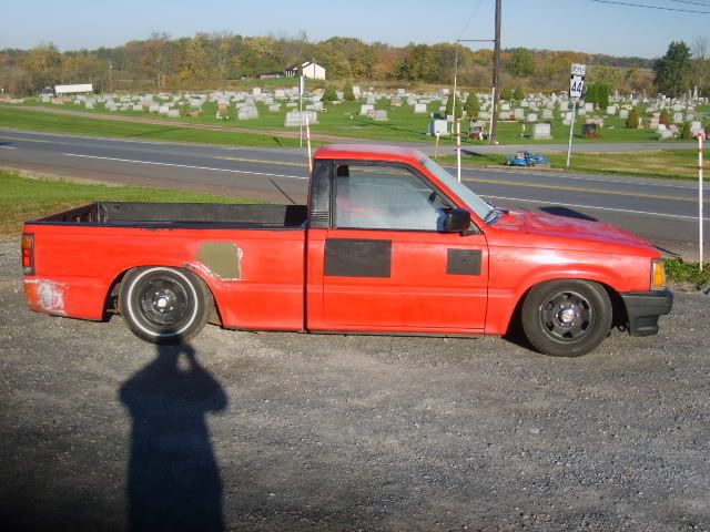

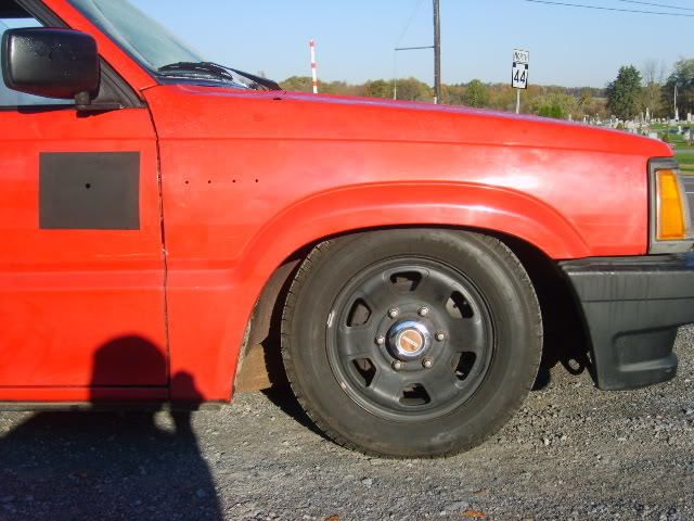

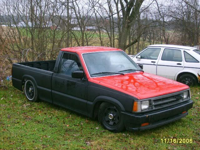

heres a few updated pics of my 87 b 2200
in these pics
Ball joints flipped
reindexed torsions
3in blocks
mono leafed
C notched
bump stops removed
185/70R14 front tires
205/75R14 rear tires
Oh yeah it was a little cold this morning

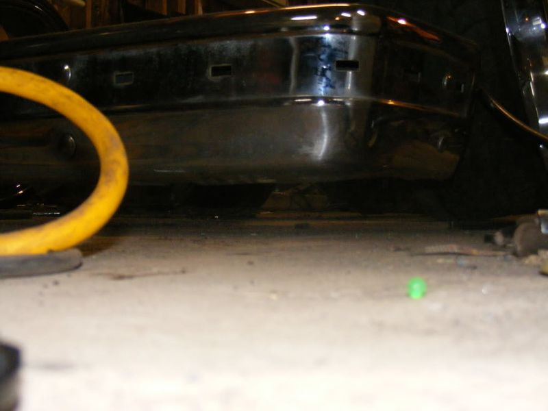

Heh heh cool bro. I'll be that low soon, ok uh not "that" low lol shall be tucking the front 195/60's on mine And tuckin the big ole 215/65/15's in the rear will be sweet lol.
lol I just noticed your frame .... Speedbumps beware!

nice lookin ride height
lowblownranger

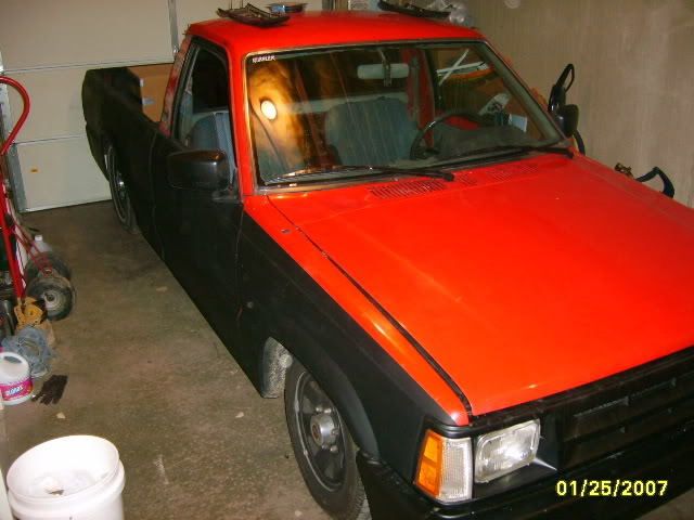

yeah now that i got the ride height where it should be i gotta get my body work done and get it painted

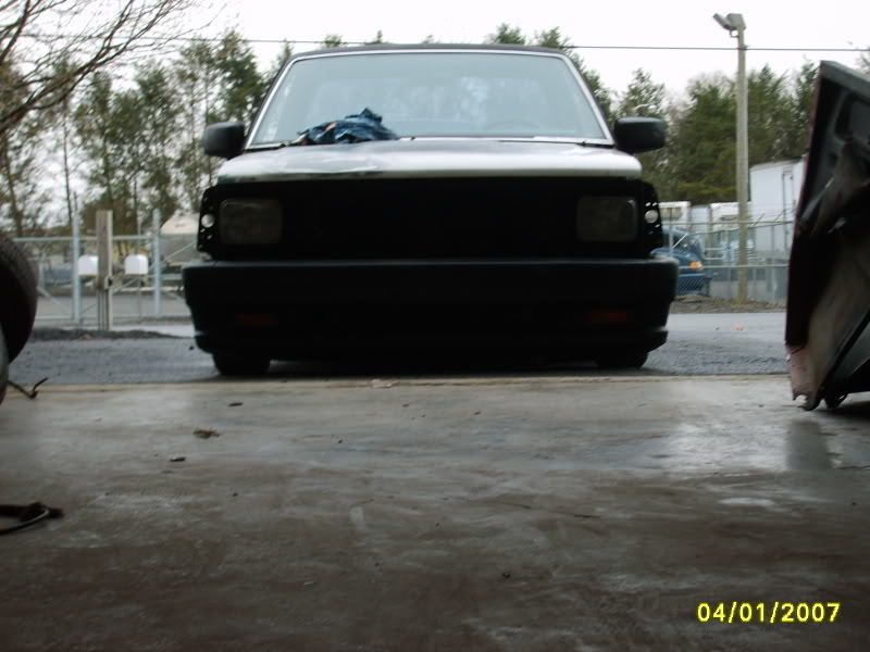

lowblownranger
yeah its def low im def not going to try any speed bumps i can say ive surely found all the high spots in my driveway theyll disappear soon
chizel
Wow, that is insane low, I love it, lookin great man!!
lowblownranger

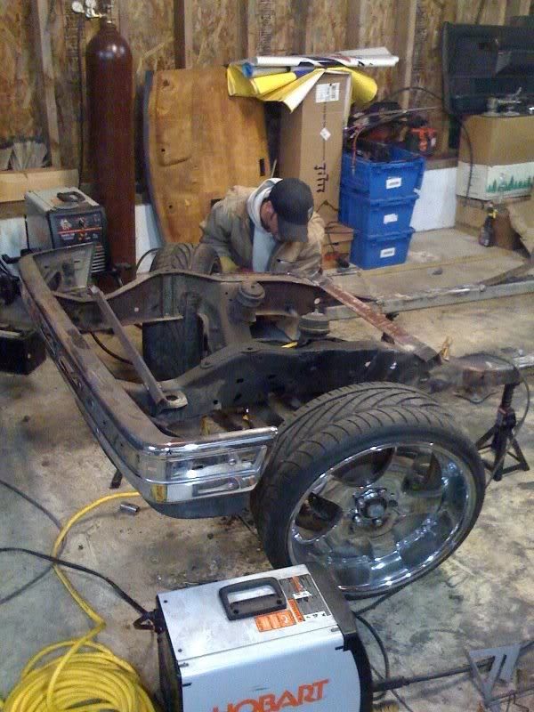

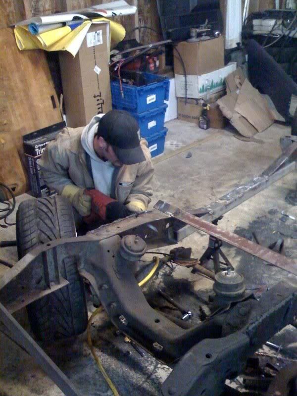

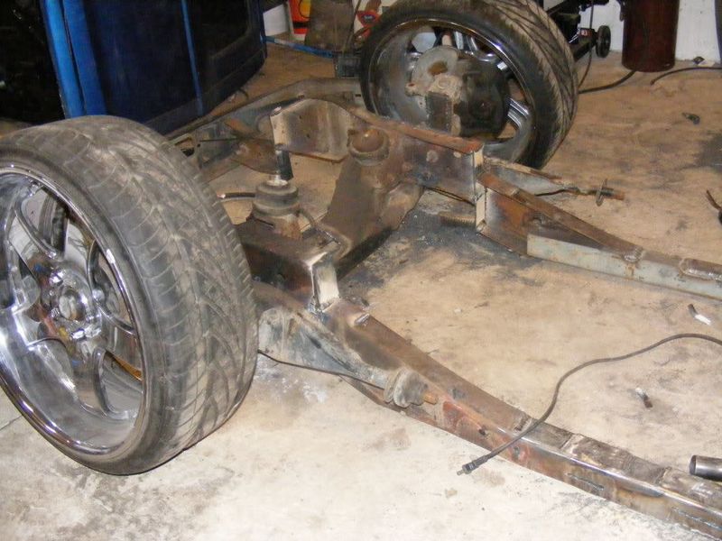

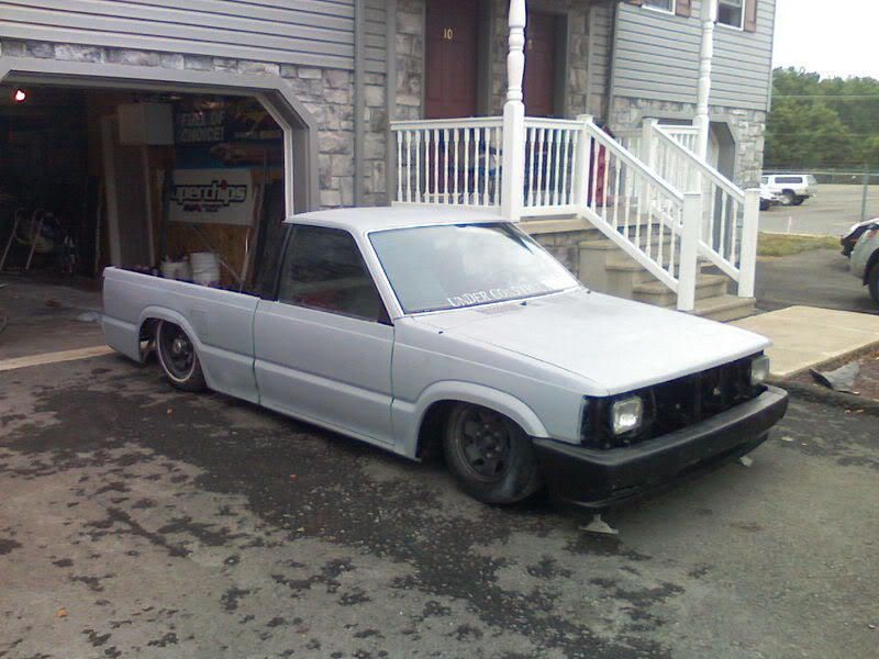

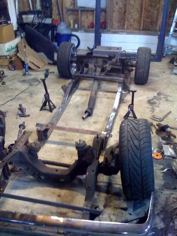

yeah after driving it today ive found out that i need to raise the gas tank crossmember and reroute the exhaust as of tomm im welding in a new crossmember and making a new plate to hold the tank up and in a few days i will reroute the exhaust ill post pics of the crossmembers tomm when im done

when you mono leafed the rear... do you have just one leaf , or the one long one and yhe small one? im wanting to get mine down a little until
i can 4- link it.... the front you flipped th bj,, are you running stock spindles?
sorry bout all the ?s.. just trying to get some ideas on what i can do...
TH

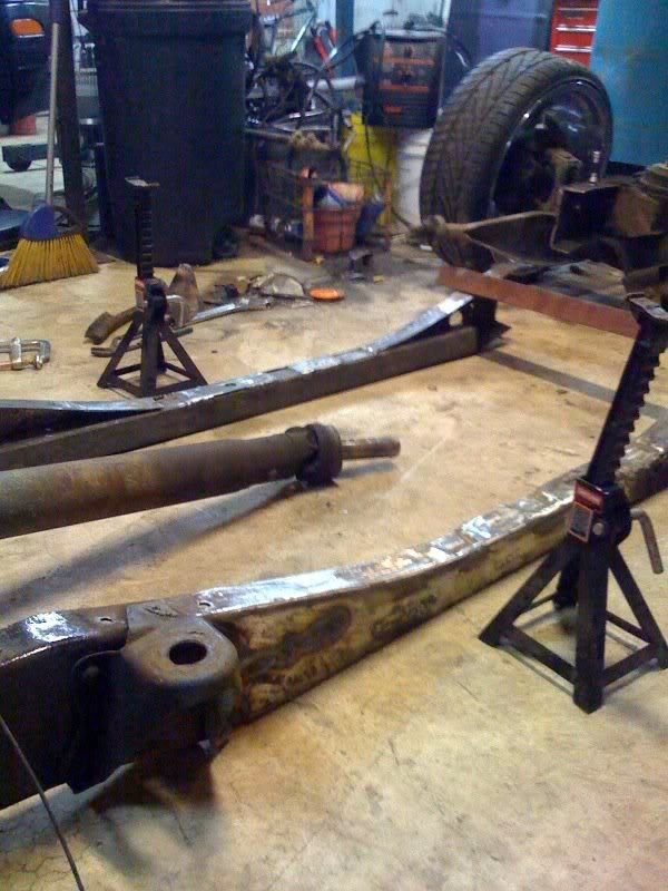

team haymaker
dude that is low, and looks awsome, but i bet money that leaf snaps, look at how bent it is, id be careful with it
