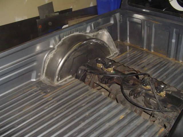

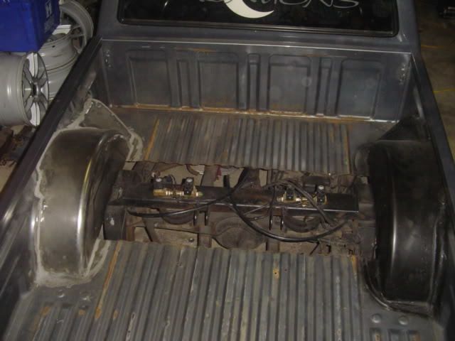

here is the old poopy overnight air tanks and stuff install, last year i had 10 days to get EVERYTHING, interior, air set up, plumbed and wired, and floorpans done and this it what it looked like, i went and did the small thing a missed over the summer and winter, then it was on to the bed

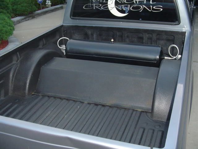

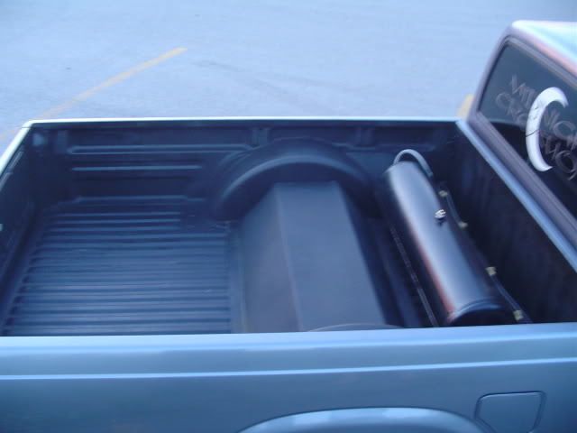

and done, for the most part,just need to touch up some of the sray on liner and paint the tank to match the truck
the only spot that has body filler is the notch cover, i had to make in 2 pieces cuz my sheet metal brake wasnt wide enough, i butt welded them together and grinded the welds down and used the body filler to smoothen it out
