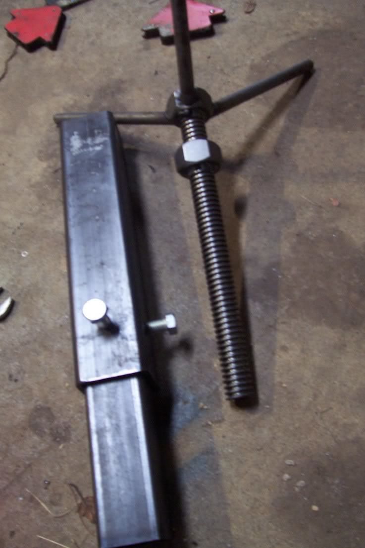

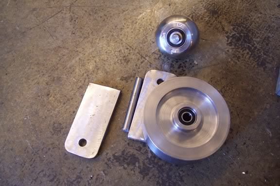

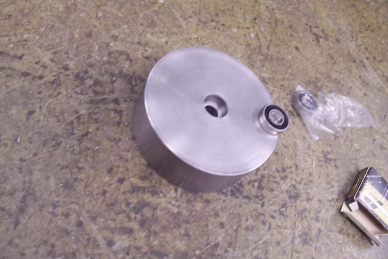

Well this has been my project for a couple of months, I hope to roll out some kickass sheetmeatal within a week or two
I made the frame, lower ajuter top wheel and mounts, the only thing i bought was the lower wheel (anvil)

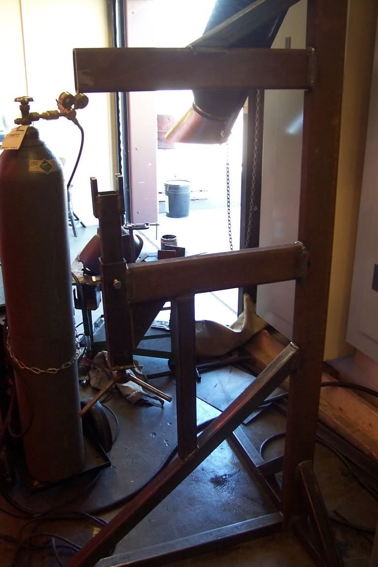

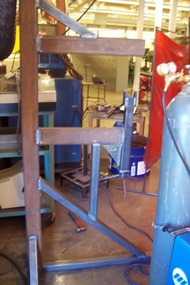

gor her home today, and started to get used to it.
It does flex when i take the metal out, so Im going to add a heavy duty bracket on the inside of the upper and add on the top, it should add more strengh and keep it from going up and down, right now its flexing about 5/16"
