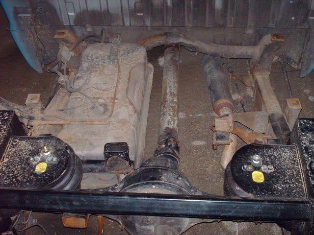

haha it seems as if everyone thinks im running this as is in the pics is clearly wrong. the crossmember is there for idea wise so chill its not permanent
Welp I ran my whole 4 link foward so i can get better pinion angle and just cause it looks better and i also relocated my gas tank.
OLD REVERSE LINKAGE
OLD REVERSE LINKAGE AND STOCK GAS TANK LOCATION
*NEW LOWER BARS RAN FOWARD*
*NEW WISHBONE RAN FOWARD ON TOP OR AXLE* CUSTOM MADE BY MY FRIEND ALSO NOTE NO MORE GAS TANK
*NEW LINKAGE, JUST GOOD SIDE SHOT THATS ALL*
THERES ONLY TWO THINGS I NEED TO DO BEFORE I WRAP THINGS UP, ON THE WISHBONE BY THE CROSSMEMBER BY THE CAB I NEED TO ROLL A FULL BEAD ON IT AND PAINT IT, I COULDNT FINISH UP CAUSE OF THE DAMN RAIN AS YOU CAN TELL IN THE PICS
so lemme know what yall think

looks better man but that's a 3-Link
slammed83mazda's avatar
slammed83mazda
in a way its a 4 link haha, upper bars are 2 but connect into one so yes its a 3 link in a way

lol thats in no way a 4 link

looks better then the old set up....so did you get a fuel cell or are you going to put the stock tank in the box??
Don't forget to post more pics when you get it finished.....

nope...not a 4 link!!!

Not to be a dick... but man that does not look good, or safe, or I dont even know what else to say... wow... that looks really ghetto.
That cross member is scaring the shit outta me... like seriously you've got your wishbone attached to that... there is no strength in that at all.
in the 3rd pic... did you just butt weld 2 peices together for your bars? man thats not good.
Wow man... this is bad work... im sorry im being str8 up with ya, this shit is not safe, and just not good. How can you look at that and think its safe or even good work??
I would not want to be near you on the road... i feel sorry for others that are.
How is everyone else thinking that even looks good. Geez people!

i can't get over this... thats beyond me how someone could even make this... im floored!

Honestly I joined this site just to post my 2 cents on that setup.
That is putrid. Congrats for going to a forward link, but that truck is a deathtrap. You built a crossmember from 1x1? and then decided it was strong enough to mount your upper bars too? and you made the lowers from scraps? like how hard is it to get 2 pieces of tubing.
The whole setup is unsafe, and it looks like shit. Where can I get me some of those tabs. Damn.
Did you get it all wet hoping it would look sexier?
