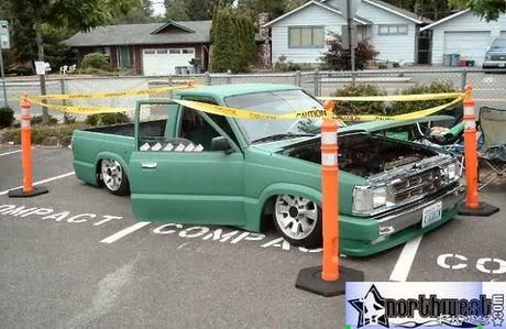

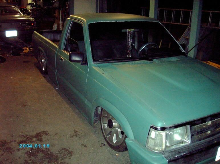

HERE IS A COUPLE OF PIX OF MY RIDE. I BOUGHT IT FROM ANOTHER LOCAL CLUB. WE HAVE HAD A FAIR AMOUNT OF, WELL, REENGINEERING TO DO... TO SAY THE LEAST
THIS SHOT WAS FROM BEFORE I OWNED IT.

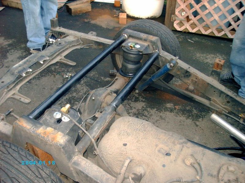

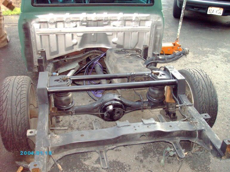

A LITTLE OF MY HANDY WORK.
WE ADDED THOSE BRIDGE BARS SINCE THERE WASNT ANY... WE ALSO FABBED A CHAIN BRIDGE TO KEEP THAT CRUMMY 2 LINK FROM OVER EXTENDING

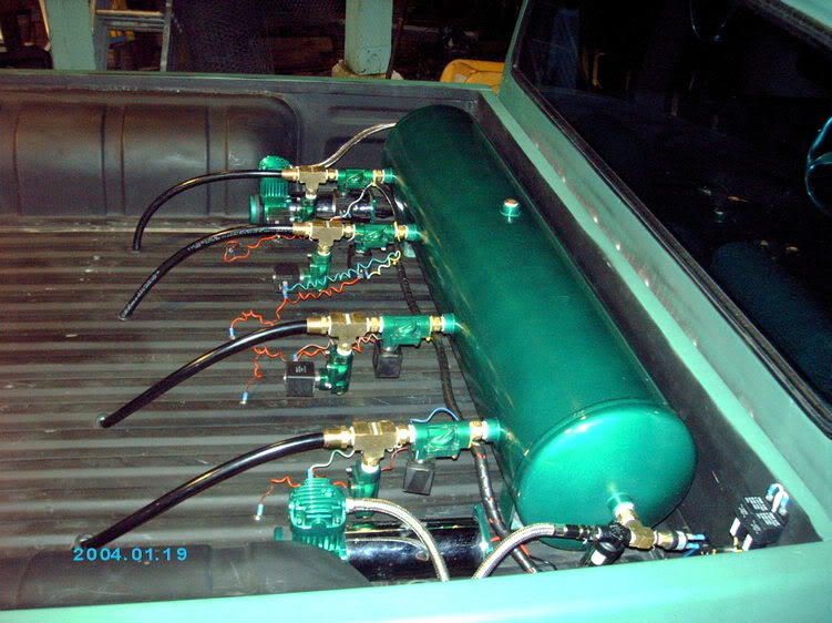

WE PUT ALL THIS IN TWO WEEKS AGO. 2 VIAR 450'S, 12 GAL TANK, 1/2 VALVES, 175 PRESSURE SWITCH, 5/8" AIR LINES. IT HOPS A LITTLE...

looks real good bro, im just curious to know why you painted the head of your compressors? i never have known anyone that does it but im just curious as if that paint would peal? since it does get hot and everything.
but ya look real good.

THAT PAINT IS DUPLICOLOR METALCAST, MAKES IT LOOK ANODIZED. PLUS THE SH IT IS HIGH HEAT LIKE 500' IT HASNT PEELED YET
slammed83mazda's avatar
slammed83mazda
thats cool, i was just wondering, is tehre a way you can paint the body of the compressors like the big long part? mine have surface rust on them and i dont have a bed cover yet ? anyone ever done this?
