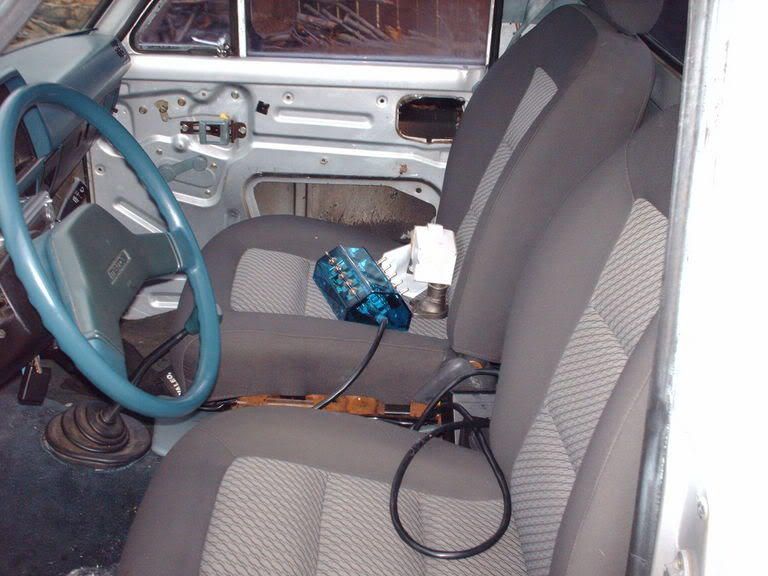

also got the sport trac seats in, interior is about well there is none, no door panels console isnt there, carpet is about gone
