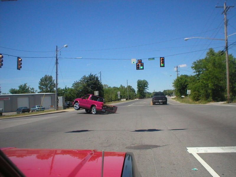

Found this on another forum
slammed89mazda
holy !!! that's sick!!
mullet
wonder what kinda linkage he has! i wanna know more!

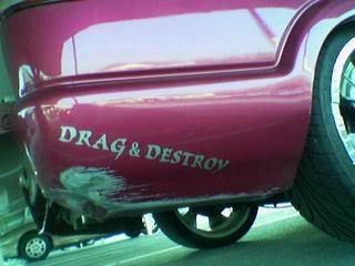

thats the rear setup on that badboy
slammed89mazda
damn, i didnt think that was bags...thought he had hydros
laiedmazda87
hmm htf does he do that with bags???
blare
Custom rear frame clip, custom 3 link wishbone suspension,10 1/2" GC Extreme 450 valves, (dual fill in front), 5/8" line, York EDC , 8 gallon tank, Big Azz Nitrogen tank, chained all around, airlift 2b7 dual port extreme bags.

plus going around the corner helps the lift.
That shit is what it's all about
mullet
he does that w/ that freakin wishbone! That thing is PERDY!
