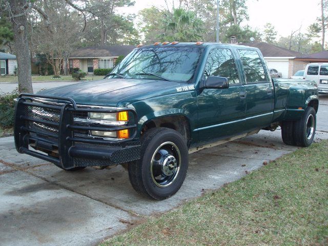

I'm wondering how people are managing to make that happen? Alcoas take the "mag style" or shanked lug nuts, and the stock GM center caps take the external threaded "acorn" style lug nuts to hold them on. but I've seen it on here, and on a dually listed on e-bay, so I know it can be done, just wondering how? I found some 9/16 acorn lug nuts with external threads for the black lug nut covers, but I have never seen a shanked lug nut with external threads...

Which Alcoas - for what application? The ones I've seen use a 2 piece lug nut - in other words with an integral washer that goes flat against the face of the mounting flange. Alcoa copies like the Eagle wheel might take a shanked lug.
GM has some 2 piece lugs with the external thread, I ran them on the Frito 8 lug 19.5's I had on my 98 crew cab, and ran the GM center caps. They fit better this way vs. using the regular acorn lug and the clamp ring.

well that explains it right there... these are the eagle alloy copy's, just went and looked. thanks man.

I used the stock acorn external threaded lug nuts on my alcoas to run the stock caps. But my wheels were originally 10 lug wheels and those were wleded up and redrilled to 8 with a taper for the acorn lugs.

I run 4 acorn dual thread lugs, and 4 two piece dual thread lugs on each wheel.
