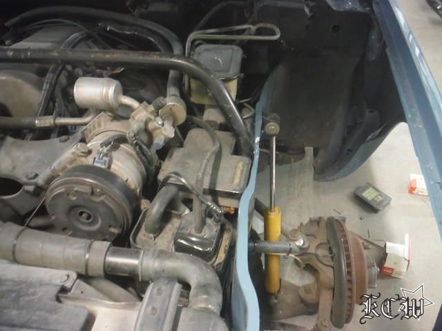

I have been contemplating deleting the abs crap on my dually. The more and more I think of it, the better it sounds. At first I was hesitant to mess with the brake system as it is already sub standard from the factory. I always have felt they could be better, they do stop, but don't know if I really needed them too, they would in a reasonable amount of space.
Anyways, what is needed to remove the abs? Obviously the controller/actuator deal (whatever it is called) needs to be 86'd , re-plumb the lines to the master cylinder. Mine does not have a proportioning valve that I can see, is it built into the abs unit? I would imagine I would need to add one, correct? Did any of the shitbox's not have abs that I could get the prop. valve from? Would a donor need to have hydro boost to use the same master cylinder and prop. valve?
I am not too keen on getting an aftermarket valve and have to try and adjust to work right.
Any other things I may be missing??

It is correct that in the 1995-up 4 wheel ABS units used on these trucks, the proportioning valve is built into the ABS unit. The only 4 wheel setups that had the external proportioning (combo valve actually) were the pre-1995 Suburbans with that monster ABS unit, which was always going bad, by the way.
Go with a Wilwood or similar adjustable prop valve, that way you can tune it in to behave the way you want. No need to stick with stock components. Brakes are designed as a system; once you start substituting/mixing parts that whole system thing goes out the window so you'll want some adjustability in there.
