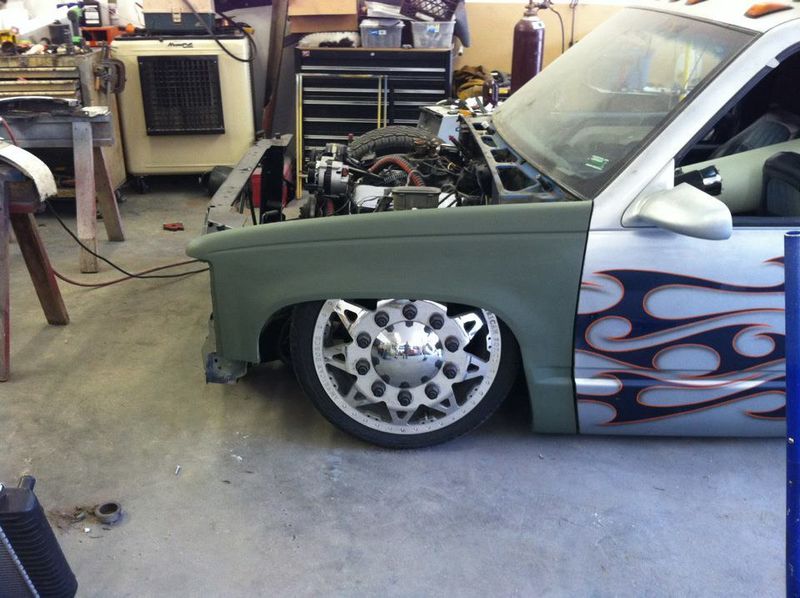

I would imagine to run that combo, the wheel opening will need to be raised. Anyone have pics of where they cut and how much to raise? Also would love to see more underhood pics showing where stuff was relocated to especially drivers side on later 90's gm's

id like to see some pics also of some sectioned fenders..to clear spikes with bd on 22s i hacked mine about 4 in already.bc they where hitting the new american forces..but they r still close and dont have the stock roll for strength..i know someone has some pics

pulled this off the dually facebook page; looks like he sectioned about 2" out of the fender to make way for the new wheels.
dysinger1
actually it i think it was 1 3/4 to be exact, thats my truck in the pic. i set it up to sit above spikes 1/4 inch.
