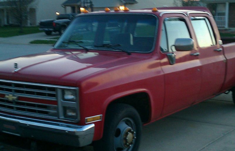

What's up, I need a little help. I've worked on many things but not a 1 ton dually. I have a 1985 C30 crew cab dually, and was wanting to lower it as cheap as possible. I know this isn't the best or even the right way but I want to drop it now. In the future I will notch and bag but not yet. Any suggestions are appreciated.

welcome man. any pics of the truck? and, that question makes me cringe everytime. i say do it right or dont do it at all. you should never take a shortcut on any suspension setup, let alone one on a 1 ton truck. if you want to bag it just save. you can hunt down used parts. spindles, shackles ect...on these sites,ebay,cl and what not. good luck.

Thanks ,trying to reduce pics, they won't fit. It's big and red..
