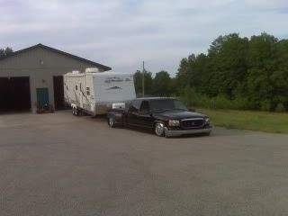

krewzlo's avatar
krewzlo
Here it is hooked up
