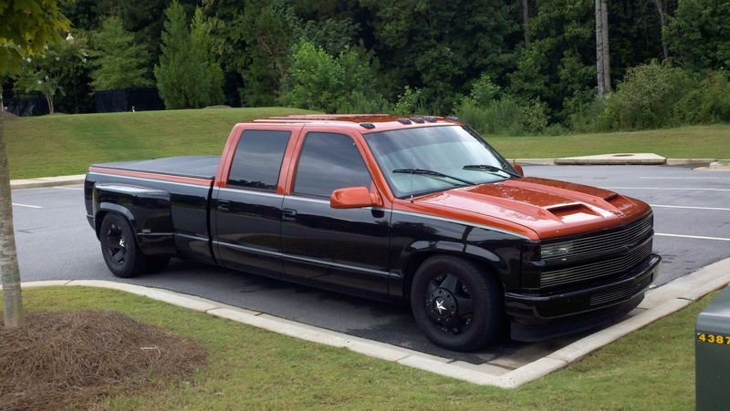

I have a 1998 c3500. I would like to know if the front rotors can be swap with a 6 lug option, Also if the rear can be swapped out for a 6 lug. I dont pull anything and would like to uprgrade the wheels and the 6 lug is way cheaper with a ton of options.

Nope, 1 ton comes in 8 lug only, you will be down grading to a half ton, might as well 86 the Dually fenders if you go to 6 lug

You could, but you wouldn't have a dually anymore. Never seen a six lug dually before. Yes there are tons of options in 6 lug wheels, but none in a dually style. Take off the dually fenders and just have a crew cab fleetside 1 ton. No need to go to six lug though as there are tons of choices in 8 bolt non dually wheels too.
