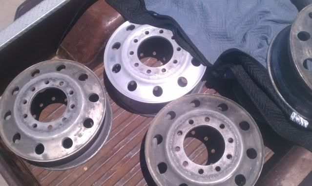

Picked me up some 24" today and I have a few questions
There going on a 80 cc dually with a 6/8 drop

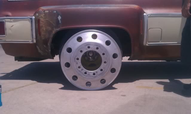

I want to run one 24 and one 16 on the back will I need to run a c&c rearend or can I use the stock rearend with out modifing the rear fenders
What size tire should I run on the 24 and on the 16
Do I need to have the face of the 24 milled down?

You can not run the stock rear with stock fenders. Having the faces milled down will help some.
lockone's avatar
lockone
You will either need to modify the rear axle or the fenders. It is very close when you just face mill the wheel but they will hit with a 6/8 drop.
There are not many tire sizes that match with both the 24 and 16 but there are a few. I would run a 285/35/24 or something in that range. You could even go down to a 255/30/24 if you wanted but they are rubber bands.

3/8" is the normal we take off the faces of these wheels. In some cases you can take 1/2" off if you have an Accuride style wheel with the thicker flanges.

I have 7 24" semis but I'm only going to use four
should I try to sell the others as is or go ahead and get them milled down
