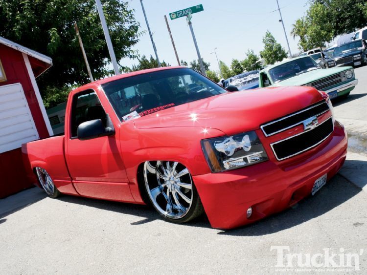

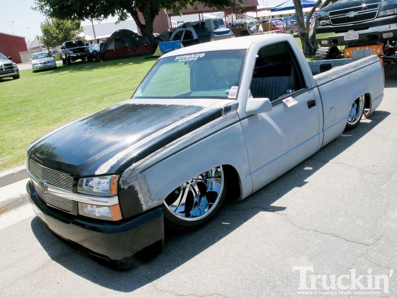

i am thinking something like this...

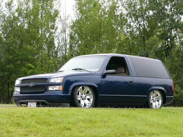

im even leaning towards this tahoe clip if i send back the gmc hood and grill
58deluxerag's avatar
58deluxerag
damn both of those look nice as hell.

I hate Red, but I'm Luv'n that pic
