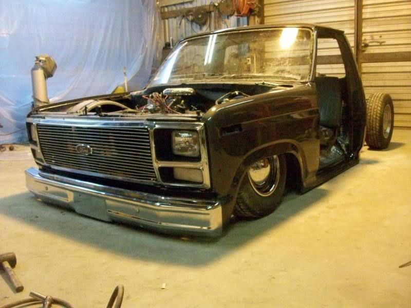

we painted my buddies 84 ford last week...we tore it completly down to a bare cab...so there are no tape lines in the door jams...we sprayed the cab and doors(hanging so we sprayed inside and outside) and wiper cowl one night and sprayed the bed and hood the next night and it all turned out even but we made sure we sprayed sealer and then the exact same number of coats of paint on all of it...we also pulled all teh windows out and he has all new glass for it...turned out great so far...maybe we can get it back together tomorrow scratch free
heres what it looked like coming out the paint booth(homemade paint booth might i add) except we had already reinstalled the grille,bumper, ect
