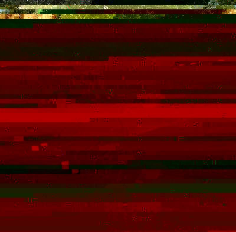

Can someone ID this grille?
1426 views
3 replies
jinxie
It is on a 88 GMC dually. I want to upgrade the headlights and marker lights. I thought GMC's (maybe Chevies) had the 1 piece side marker. I may want to change the grille back to GMC, but want to keep a 2 piece marker light. Would like a solid black grille too. I guess I need to know the year of this one so everything fits the same.
Thanks.
1967rs
Looks like the stock 88 grill, just painted.
jinxie
Did the Chevy grille always have the 2 piece marker lights?
What year did GMC goto the 2 piece marker? Can I run a 2 piece GMC grille on my 88 without changing too much up front?
bhb
The one in the pic is a '88-93 chevy (silverado)
Chevy always had 2 piece side markers. '88-'93 markers were different than '94-99. GMC went to two piece
markers in '94 . When ordering 2 piece aftermarket side markers for GMC, make sure they are for a GMC, they are different for a chevy.
To convert to a'88-93 to a '94 up grille, you need the grille, filler strip, (body colored part between the bumper and grille) '94-up bumper brackets, and turn signal housings. (and side markers, obviously)
