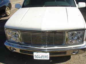

here is some mods I seen on craigslist

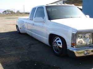

this is cool too ,think the dually housing have room for this mod ?

As far as retrofitting real projectors, there have been a couple people over on FSC that did it, the problem is there's not a lot of depth behind the headlight housing so you end up chopping a hole in the core support and doing a bunch of hacking.
Pretty sure WellBilt's talking about his squarebody so he's dealing with sealed beams anyhow, quad stacked sealed beams on the '86 model. There's H4 style glass housings out there for the large single sealed beams, probably some out for the smaller stacked style too. You can retrofit an HID capsule in there easily or just a brighter traditional halogen type capsule.
