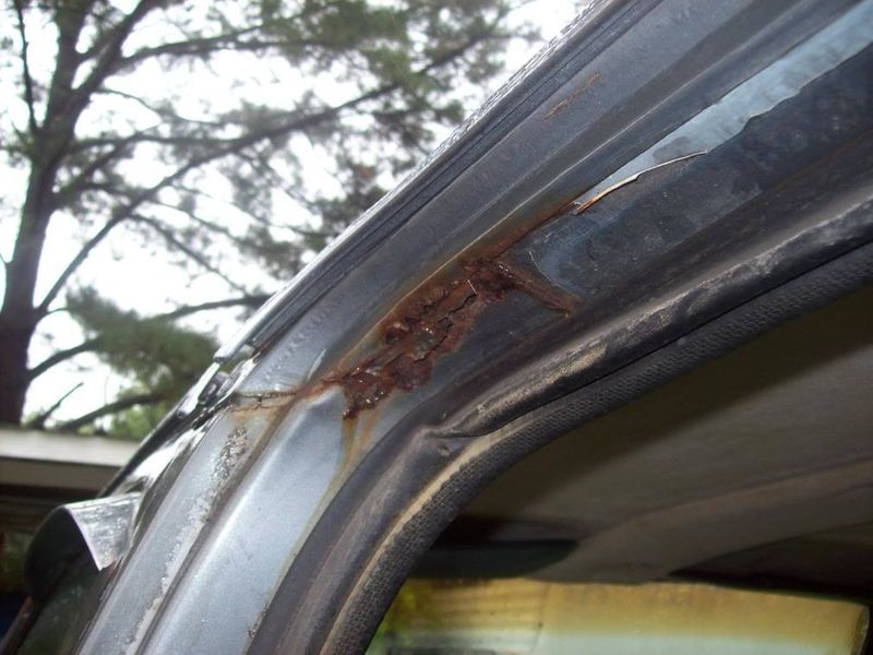

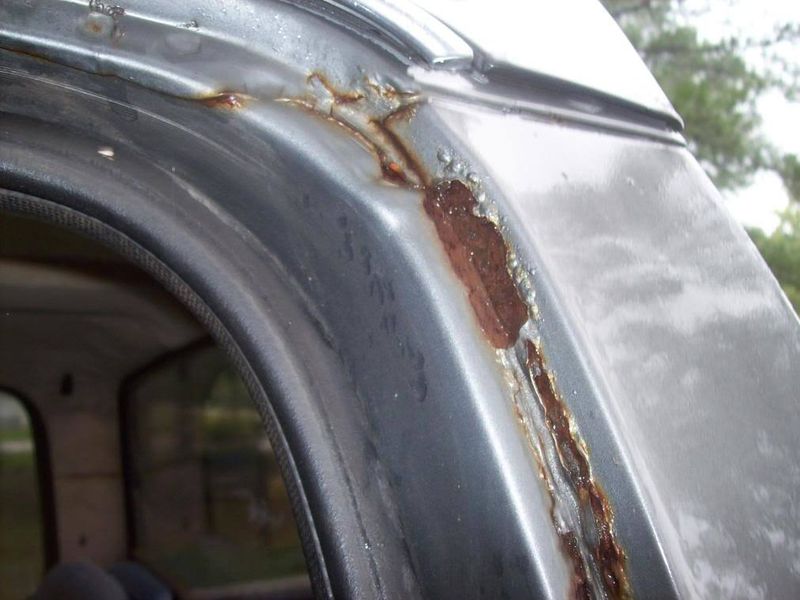

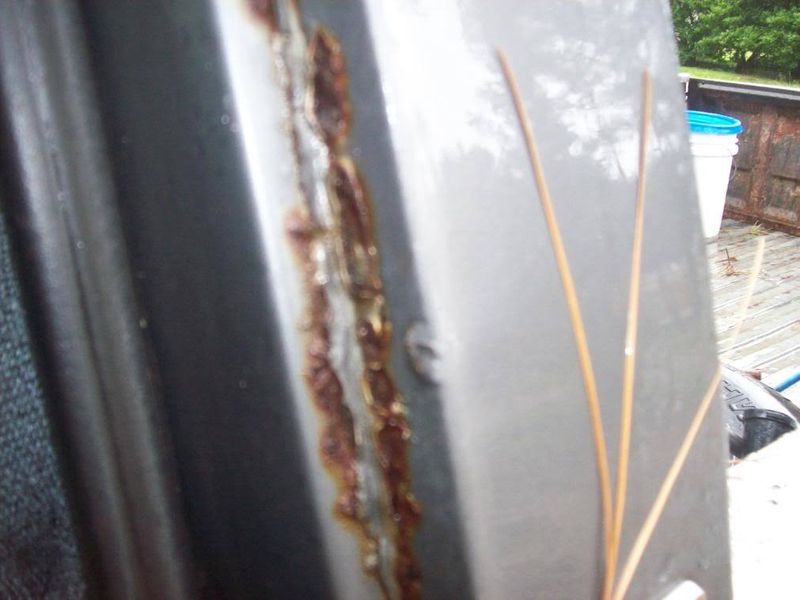

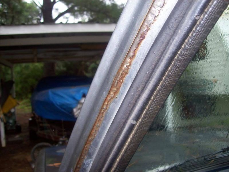

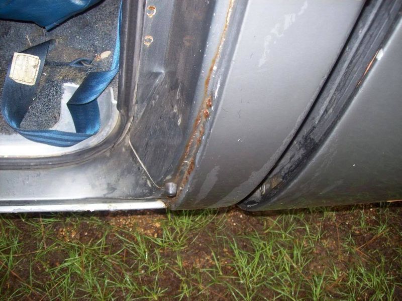

Noticed yesterday my 86 cc has some rust spots. The rocker and cab corner on driver side I can handle. But it also has rust in the door jamb where the seals make contact with the jamb to seal. Looks like that will be some work. Anybody got any suggestions on how to get the rust outta there and repair the damge. If u guys need pics of what i am talknig about, i wil take some.
1986crew
here are some pics.
W
watahyahknow
i'm having the same problem with mine , the problem is that its multiple layers of steel with rust in between .
i have a second cab wish is allso rusted but has better jambs and i'm going to try to cut those out and craft them into the parts that are rusted in the better cab .
it will be hard to fabricate those pieces out of flat steel .
if its not too bad piece you can brush the rust out and weld the holes up with copper/brass and a torch , that way it whont rust further

first off your gunna wanna go to a paint supply store and they make stuff that you and brush on the rust to KILL it. then you will have to just grind it all out and see how bad it is. if its not all the way through you can just mud work it. if you got holes everywhere you really need to replace the sheet metal
