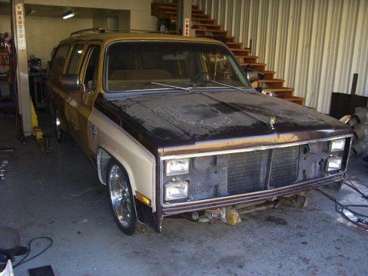

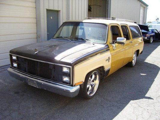

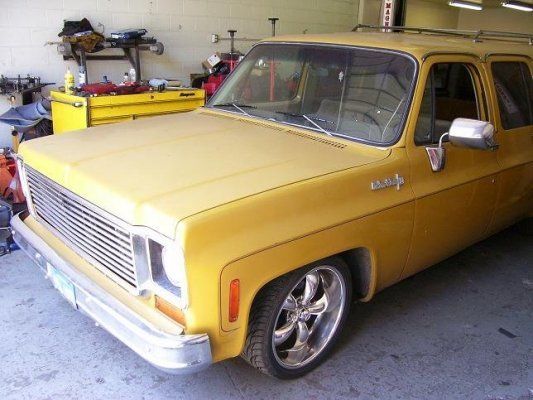

Well I just swapped my 73 Suburbans clip out for a front clip of a 86 Chevy truck. I thought that some people might like to what it takes to do this, everything I found on line did not show what it takes so I took pictures of my swap. I did this on my Suburban, but the same steps apply when doing this swap on a Dually.

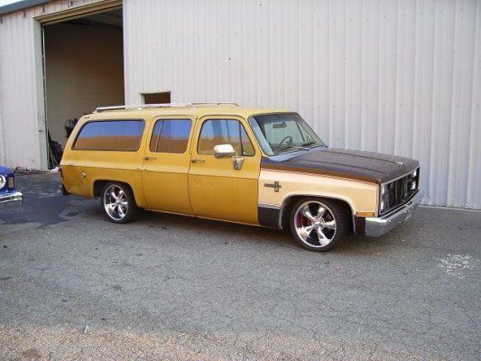

The unsuspecting Suburban.

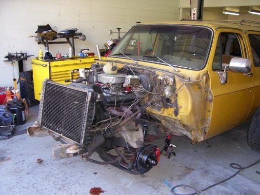

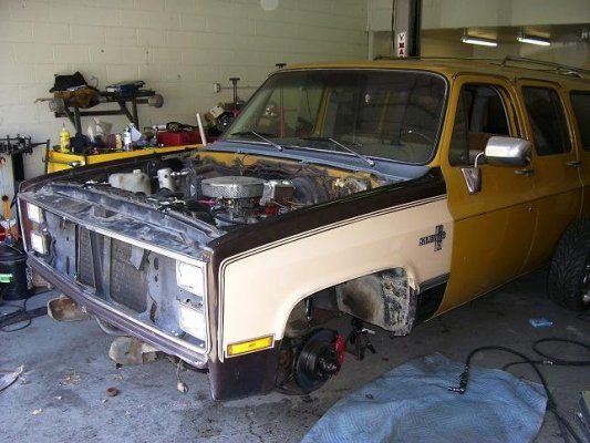

The 73 front clip pulled off.

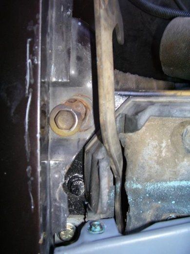

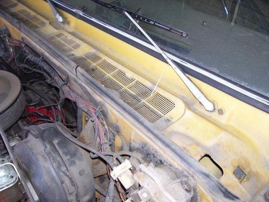

The plastic screen, weather strip & wiper mechanisms need to be removed now.

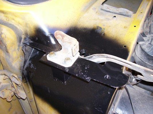

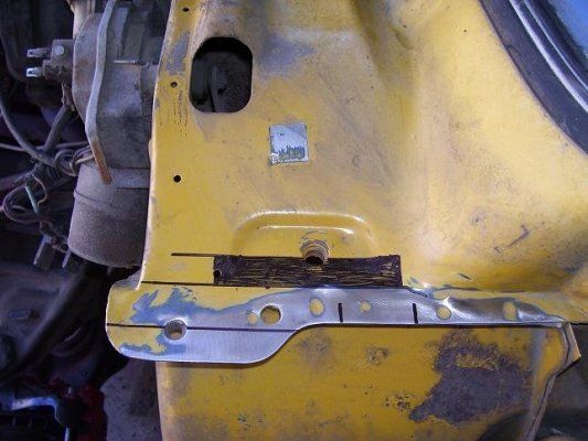

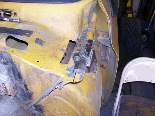

Now time to mark out where the cutting for new hood hinge holes & bolts need to be.

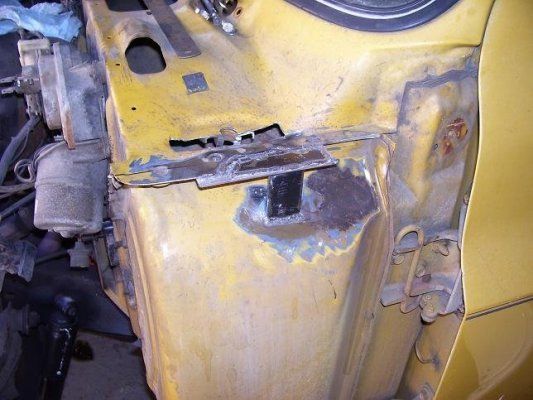

Here's where I had to add metal for the hood hinges, I added some support also, it seemed a little flimsy without it.

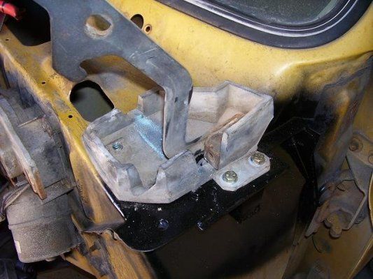

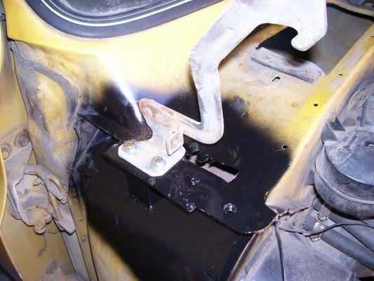

Test fitting the hinges.
With rubber.

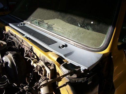

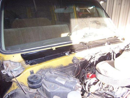

Now it's time to drill holes for the wiper mechanisms, plastic screen & cowl. I forgot to take pictures of the drivers side wiper mechanism hole, it had to be enlarged to fit the longer mechanism.
After hoes drilled in the right spots I installed the cowl.

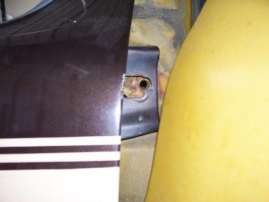

Here you can see where I had to enlarge some of the holes to get the clip lined up.
Now the fenders are shimmed & bolted down.

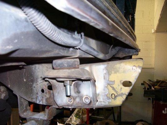

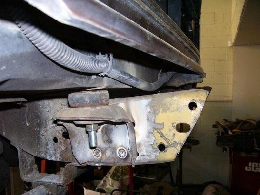

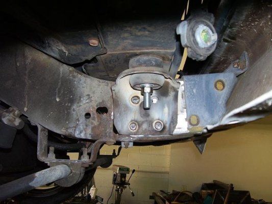

The front body mounts had to be cut off & welded on in the right place along with cutting the frame for the bumper.

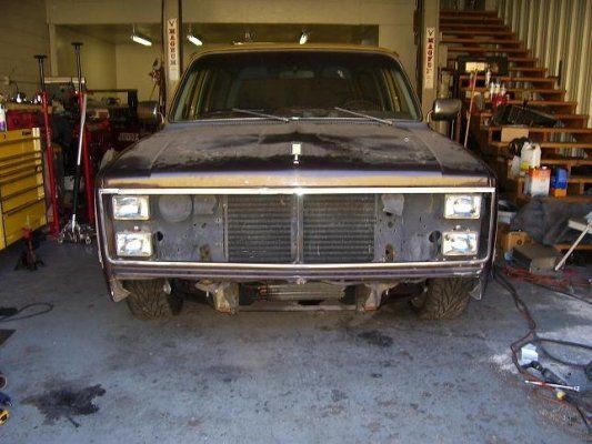

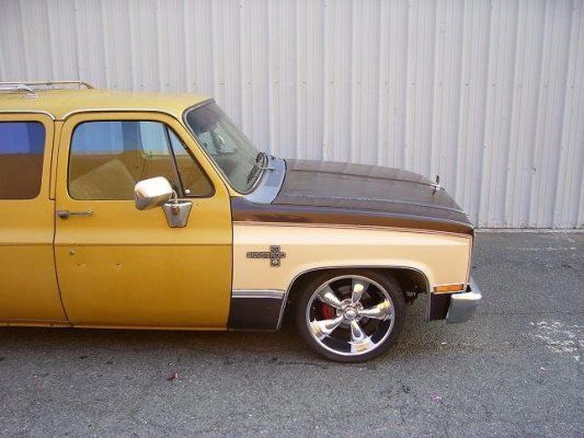

Ta Da! It's on.
