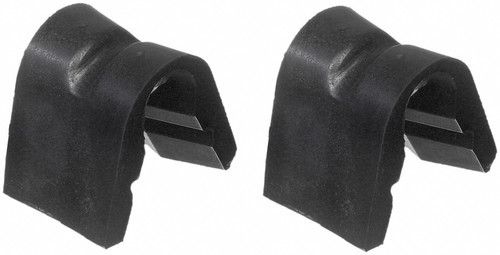

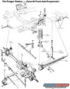

Also Dragn, would you possibly have a picture I could use as reference? Im having a hard time picturing it in my head, im still somewhat new to truck suspension and 4X4.
dragnframe2000
Cross members should be the same, might have to move it forward or backward.
This is what the bushings look like for the radius arms
borrowed this pic, you can see the bushings towards the bottom of the 44 how they clamshell around the tube with the v-shaped or diamond shaped mounting pad. We've done two dana 60's that way. first one we cut the mounts off the 44, 2nd one we made our own.

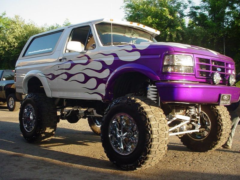

this is one of my workers bronco, its still a dana 44 but you can kind of see on the drivers side what the mount looks like. hope all this helps
