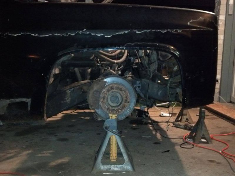

Has anyone got some good pics of their STOCK control arms with the bj's moved up?? Im having a hard time finding pictures of some. I'm debating cutting and moving the ball joints up and cupping the lca's, im just not getting low enough and spending $400 on drop spindles isn't really in my budget.
I'll be running stock 16's on a 245/65/r16
I attached a picture showing where I'm currently at.
mdub4life29
is it z'ed? if you just cup the arms you should be laying front of the frame on the ground
screwcab
No it isnt z'd. I'm putting a 24v in it and want as much room as possible under the hood.
Just cupped lowers on 16's should lay the crossmember?
Anything else besides pie cutting the uppers?
screwcab
Ah! Its called stepping. Searched stepped control arms and found everything I needed.
mdub4life29
^^ this is true but its ok we don't need to flame him. ya pie cut and cup. there are some good build on here try luifers just has his cupped. if u have any questions he is really good about helping out
