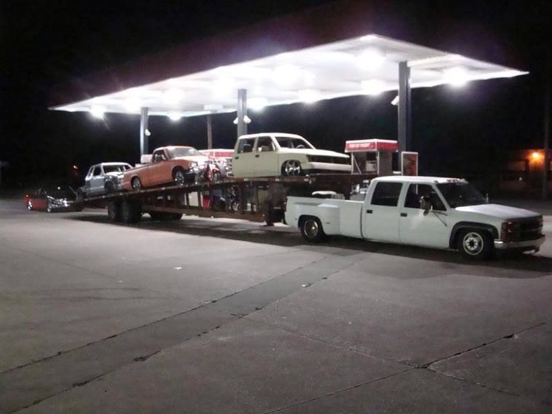

Run them ontop of the axle if you can. I just had a gate valve on mine I left open when I wasn't hauling and when I put weight on it I just closed the valve and put around 50lbs in the bags. It held up a 3 car wedge no problem.
