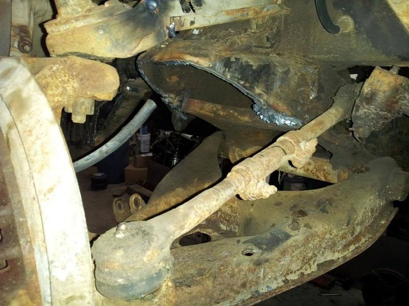

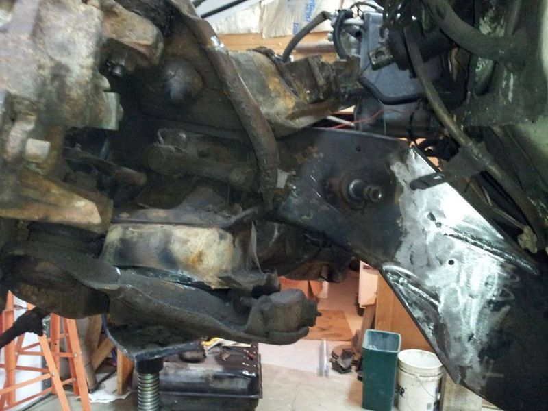

The only way I could get the LCA to stuff was to cut out 3/4 of the spring pocket... Ican't say I've seen this in anyone else's build threads. Here's what it looked like with a little grinding. It didn't stay that way for long. With pie cuts top and bottom I got it there. I should have cups and bags in tonight.

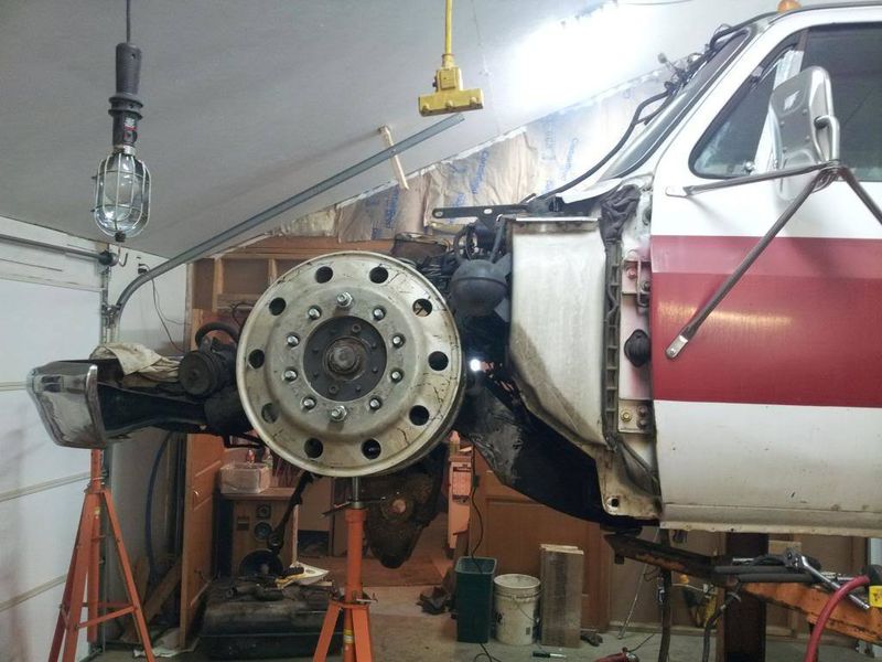

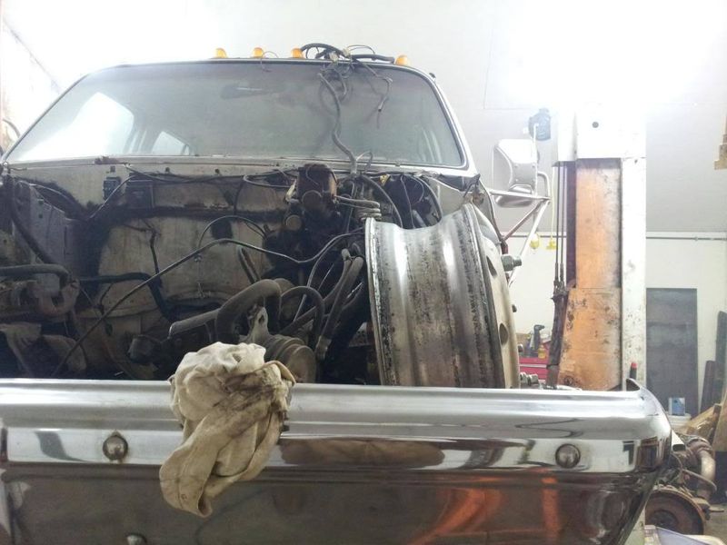

I edited the link, I'm not sure what's going on the pics works for me. I did get it to layout. It took allot of cutting. I ended up cutting most of the spring pocket out stretching the lower 2.375" and the upper 3". You have to clearance the backside of the uppers and pie cut the ball joints(I did both uppers and lowers). Here are a couple shots
