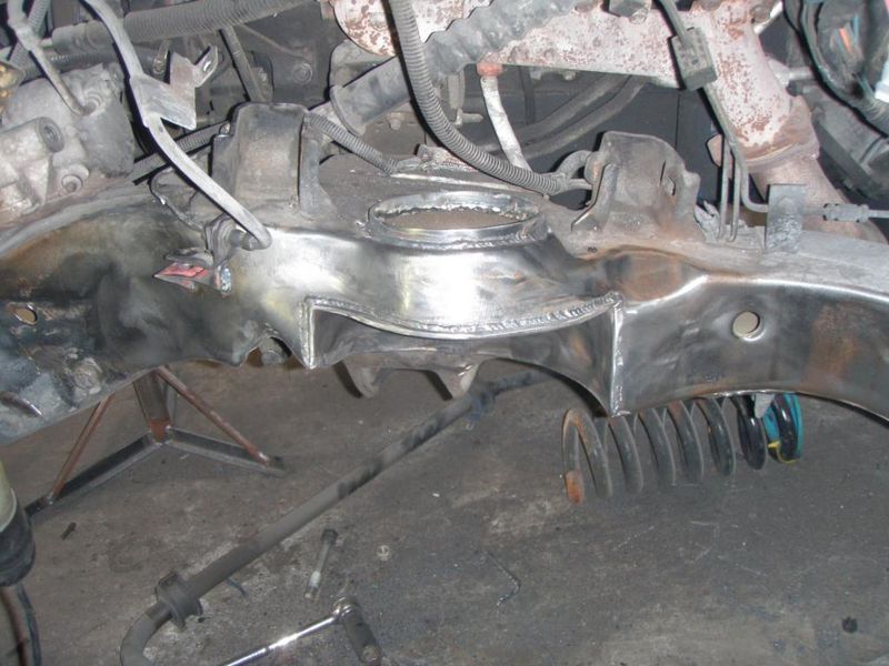

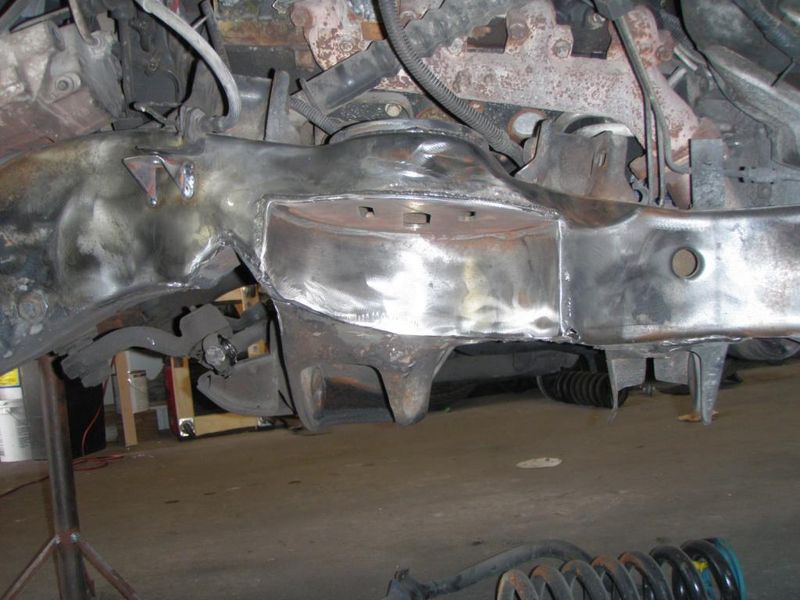

What are you guys that are running extended arms doing with your brake lines? Specifically on a 90's shitbox. Are you just relocating stock ones or getting longer rubber lines?
gjf's avatar
gjf
Just unbolt the bracket where the hard brake line terminates. There is enough line to re-bend and place the bracket on the outside of the frame right below to the forward control arm mount. I fabricated a small bracket from some 1" box tubing and bolted the hard line to it. You still use the factory brake hose. I lengthened my arms 3" and it will inset the wheel a total of 2" compared to stock.
