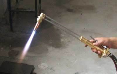

Then there's always the ol' hot wrench...

Dont't think it hasn't crossed my mind......

It'll look cool as long as you don't notice it's sitting lopsided, but you'll hate yourself the moment you take it for its first real test drive.

B) You can do the "ol hot wrench" to buy you some time, but two things- First You must run a front sway bar. Secondly, the trick to this is simple. Where you want to super heat the coil is as low as possible. Ultimately you want to get the coils to collapse and lay on the coil below it. This will make the coil less likely to have a modified spring rate throughout the coil. Also, if you should damage the temper and it snaps it will most likely only drop a small amount and not leave you stranded.
But... being that that was a "back in the day" trick and drop coils are super cheap now, there's almost no excuse for not just buying a new coil.

I don't think torching it is a worthwhile option. I can wait a lil bit until I can buy the kit. Just don't wanna spend more than I have to.
