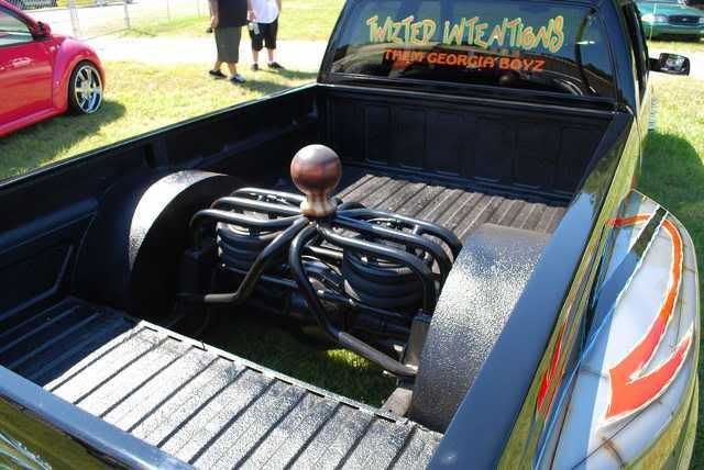

Is this guy a member on here or does anyone know him?
I'm wanting more info on his rear setup..

what the hell kind of ball is that on the top of the bridge? that thing is huge...lmao
BB
big bear
lol
BB
big bear
like a bowling ball
cokezero's avatar
cokezero
oversize gooseneck lol...

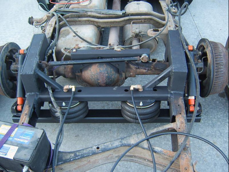

Don't care about that. just wondering the setup he has the triple stacks on

They look like Contitech Triple Stacks to me. If they are larger they are the actual semi ones.

I run triple stacks on mine and love them. Mine are behind the axle though. I like the truck above but the wheels are fugly
cokezero's avatar
cokezero

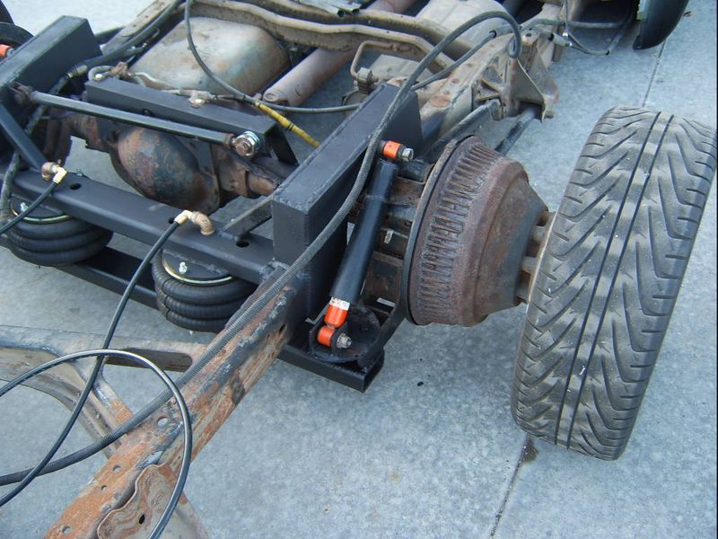

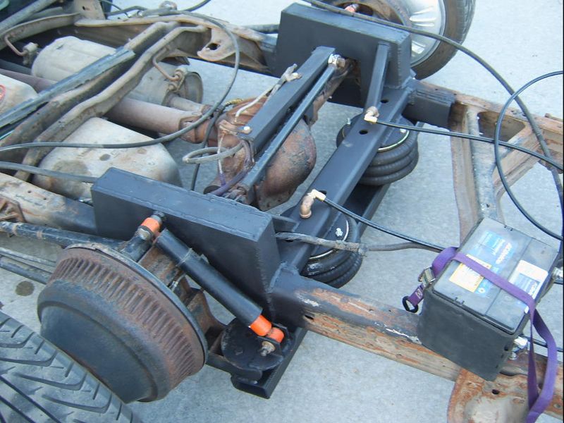

Do you have a 4 link with them?
Also you still tow having them behind the axle?
krewzlo's avatar
krewzlo
Yes I run an air ride tech bolt on 4 link airbar kit. I tow a 10,000lb tag camper with a 600lb quad in the bed and rides smooth as glass at 60 psi. I get tons of lift and rides great unloaded as well at 25 psi.
