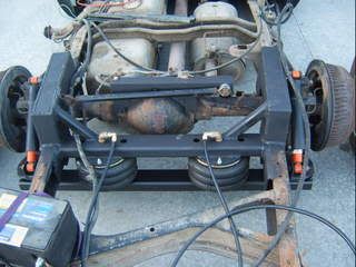

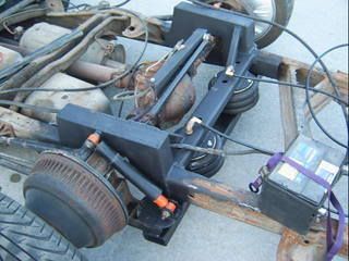

I run triple stack bags behind the axle, ride is great, over a foot of lift and tows awesome. Install isn't anything special or great looking but function is how I built it, no fancy tubing or anything like that.
