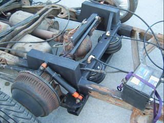

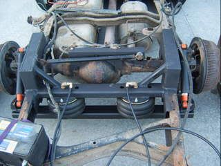

I have the art airbar kit on my truck. I used to run the bags that came with it and they were alright, but now I run triple stacks on it and the ride is way better. They are mounted behind the axle. See the attached pics. I run some shocks I had layin around the shop.
