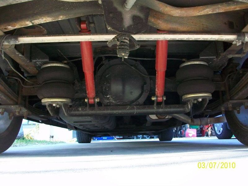

looking for advice,tow a 32 ft 3 axle tag trailer with my 94 chev 4dr dually slammed with a flip c notch etc question I have is i have very little clearance to the snubbers when loaded maybe 2 inches Bought a over the counter airbag hepler kit but no way it will work what should I do?add more to springs or add a custom air assist deal PS it has a lite duty air bag setup now thats sits on the springs in front of the axle.Any help greatly appreciated

We usually build a bridge across the frame rails and hang the bags just off the back of the axle housing. This will also give you a bit more lift power on the air ride.
jackattack
ok yes I guess that is my only option was lookin for the easy way but that makes sense ,thankyou

I had the same issue on my 1500. It was so low that the helper spring kit actually made it worse and bottomed the bag out so it rode like a rock when aired out. So this is was I did and it should be the same process for the duallies:
I used the upper brackets from the helper spring kit, plated the frame and bolted the upper brackets to it. I got a set of behind the axle lower bag brackets and it work out perfect. I also used a bigger bag too.
