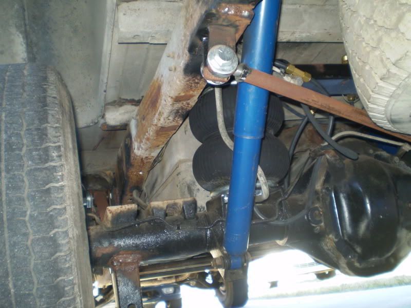

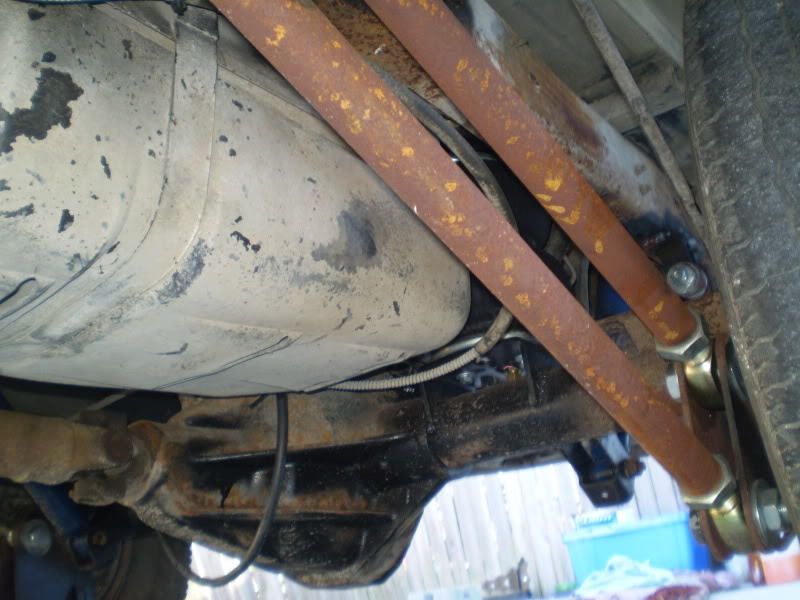

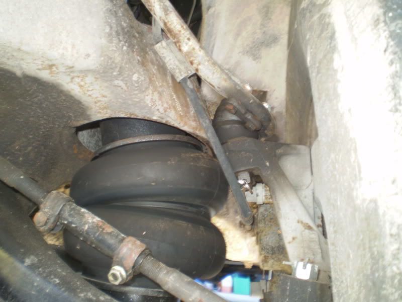

Added pics below
Picture of front drivers side bag: (no shocks up front)
Pic of rear: (only on side has shock. 4 link with panhard)

In the rear - Is the link adjustable? If so you should be able to adjust your pinion angle. That is the #1 killer of carrier bearings, and the next is not having it on the same plane as the rest of the driveshaft. I think that most of the carrier bearings need to be raised around 1" or so. It also needs to be notched if you are wanting to lay frame.
In the front - It depends on what they have installed on the truck. If it doesn't lay now more than likely they just shoved some bags in place of the springs. You will need at least a lower control arm or spindles. Also make sure that the pocket is trimmed so that the bag does not rub on the frame.
Pictures would help also.
