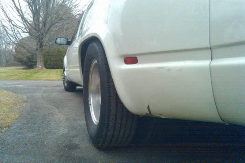

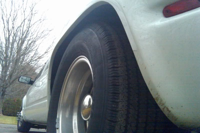

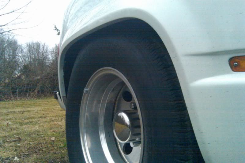

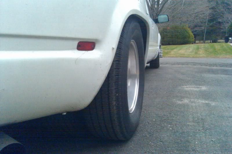

Heres some crappy cell phone pics, but you should get some idea of how they fit. I know a 245 is a bit big for a lowered 2wd truck but I think they fit well.
muskratt2's avatar
muskratt2
nistaech414, Looks Good! I like that low profile fat look. I have 235/85r16's now but I don't like that look of the high profile tire. I was thinking about going with the 225/75r16 tires but I don't like the way they look. They actually look like tricyle tires to me. This is the look I wanted. Thanks for the pictures they look great!
