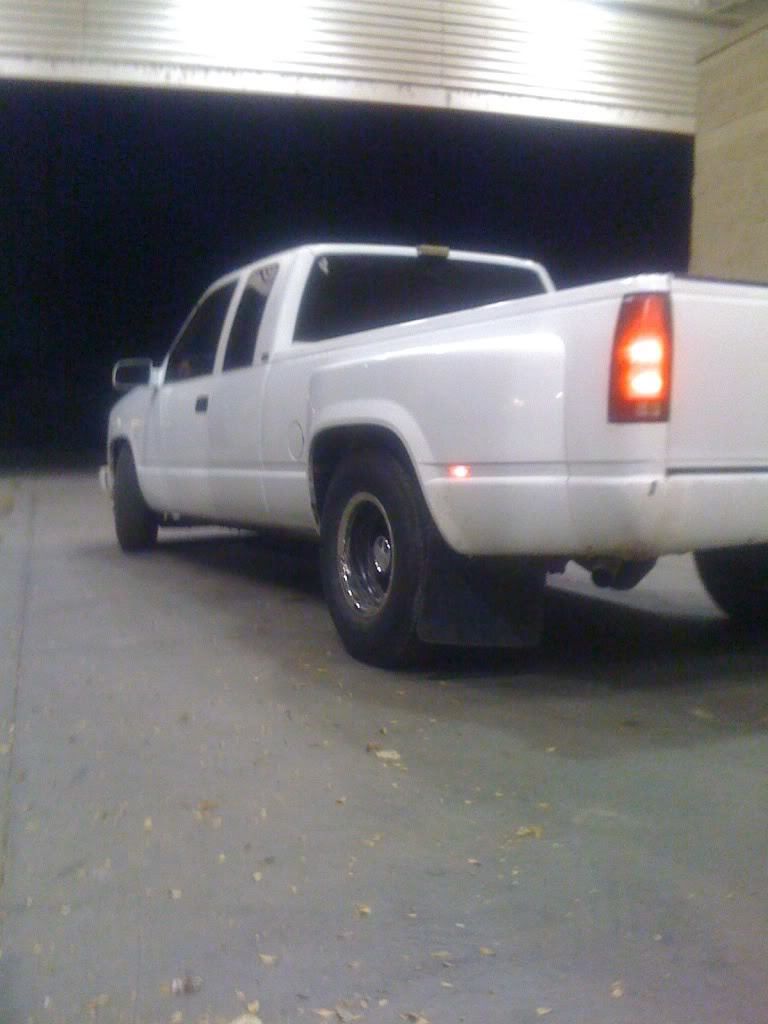

Hi all, i want to level out my dually, the fronts already dropped pretty good. Just the rear needs to come down a bit.
I need some ideas of how to get it lower, i thought about putting the axles over the leaf springs, how much of a drop would i obtain?
Heres a pic of my new baby.
sorry for the crappy cell phon picture, i havent gotten a chance to take some good pics just yet.

It looks like the rear might be dropped a little too, maybe it already has hangers and/or shackles installed? If you install a flip kit with hangers and shackles you might get too much drop. Anyway check it out, and good luck! Nice truck!

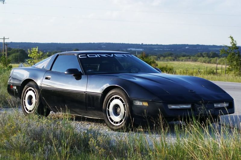

Im pretty damn new to the truck scene, im used to lowering corvettes.
Heres my old car, before the dually.

If it has hangers, you can tell by the hangers being bolted into the frame, and the spring eye along side of the rail, as opposed to below it. the originals are riveted in.
