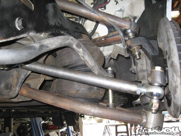

Mine was bodied on 24s.

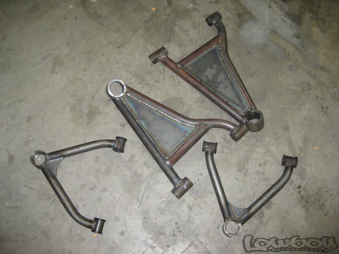

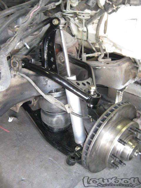

Just bagging the truck on 24s you will have to tub firewall. You can probably keep the heat/ac box(not sure). You will need to raise the fenders out back for clearance and possibly widen them depending on the path you take. Control arms will also help any camber/clearance issues you will encounter.

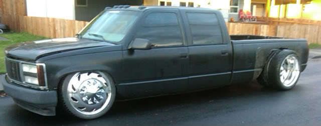

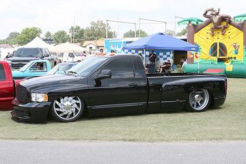

nice!
bagdduallyon24z
tuckin22's avatar
tuckin22
^that looks sick man. any more pics?

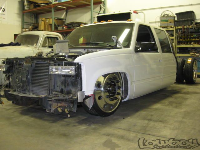

I have heard you say on 22s you need around 3.5" wider fender with a stock rear end. what kind of width change would you be looking at for the 24s?
psylent's avatar
psylent

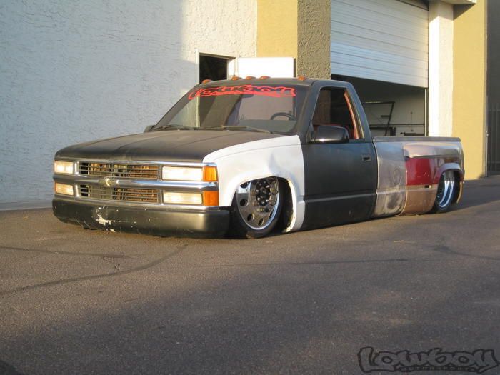

Is the Firewall tubbed in this picture?

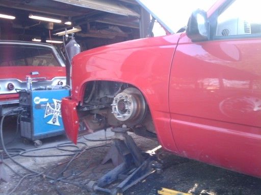

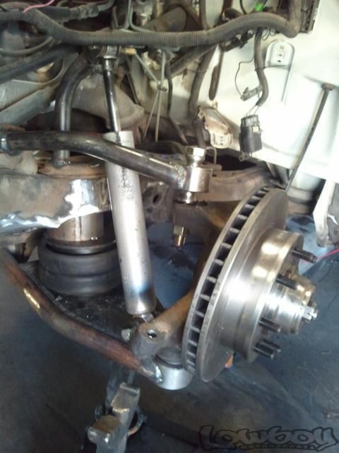

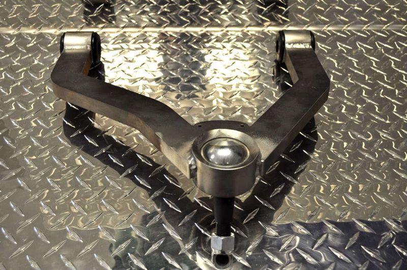

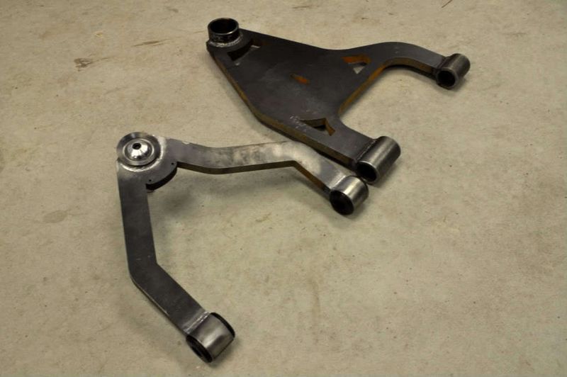

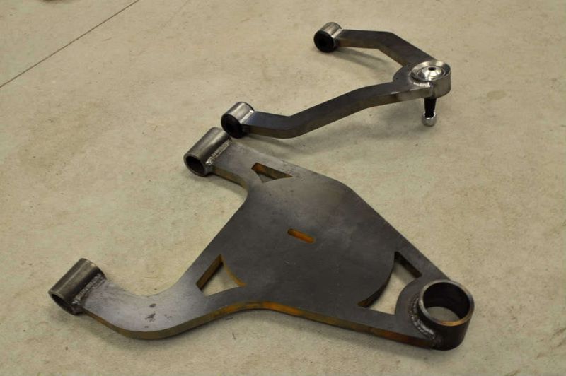

Well I got my 24s today, I got em on the front. They do not fit, there is no way they will tuck. I am running 295/35/24 size tires. It looks like I might have to section my upper and lower control arms. You guys got any ideas? They are gorgeous though! The backs go on tomorrow, I am assuming I will have better luck since I know I already need to stretch them fenders.
