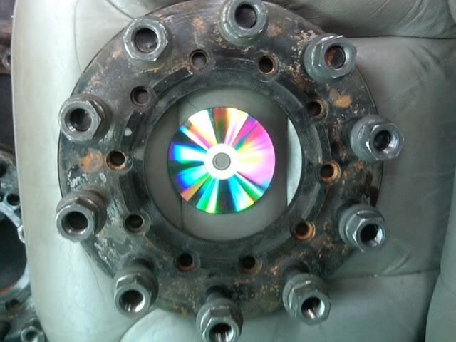

Here is a pic of the front I snapped... These guys are huge so I put a CD in the middle to show you.
lockone's avatar
lockone
WOW.
Never seen any like that before besides some that I tried making. The problem is that the smaller 10lug pattern is outside of the hub bore for the bigger 10 lug pattern. You will have to machine clearances in the wheels for the smaller 10lug studs and nuts to allow the wheel to center itself correctly on the adapters.

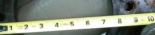

Measure across btw the centers of 2 studs for us, so we know what the 2 bolt circles are.
psylent's avatar
psylent
I will do this here in a few... I am at work and just happen to have them with me.
Looks like about 8 3/4
