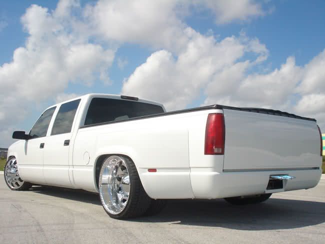

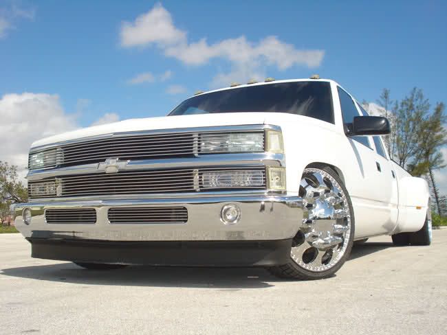

Is it possible to get this low with out air? Obviously modifications would need to be done.
milkshake's avatar
milkshake
i dont think that truck is on air ^
