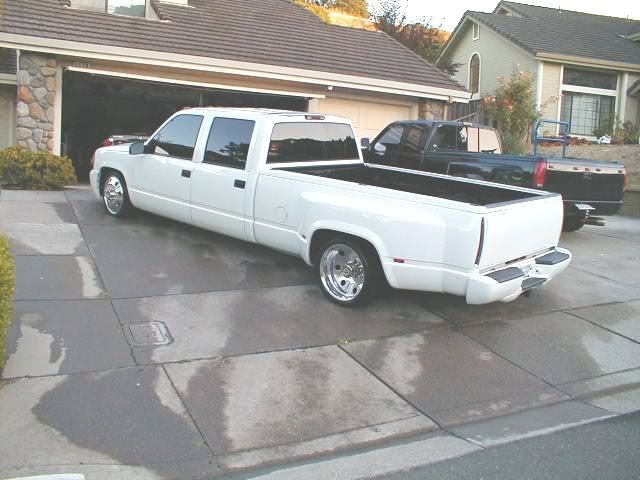

I have a 5-8 drop....more than low enough, any lower and I would have trouble over speed bumps as I already bottom out....you should buy a truck already set up, cause you are looking at big money , you can build four s10's for the cost of one dually...my bumper will crash into parking stops, and is lower than a soda can standing.
98crewcab's avatar
98crewcab
Take notice of the sidewalk and curb height

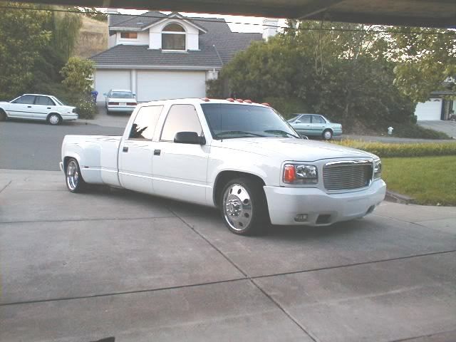

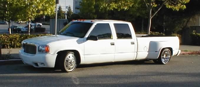

and here is a reference for frame clearence
98crewcab's avatar
98crewcab
dang . ...thats low.....
the 5-8,6-8 is still drivable for the dually.you could go lower.
5-8 is with belltech 3" drop spindles and 2" lowering springs
rear is a flip kit with some overload leafs removed and c section
