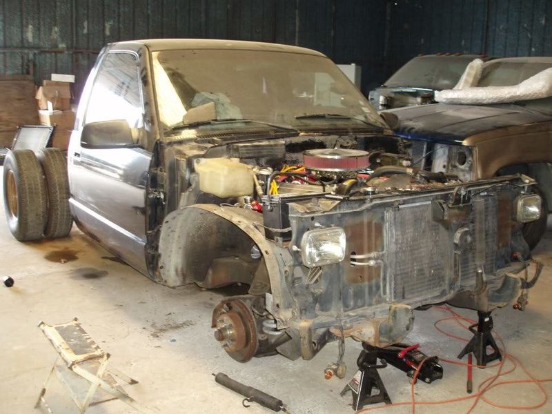

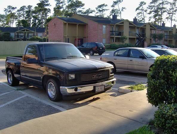

Ok , i have a 1988 chevy swb stepside with a 502... i decided to switch to dually setup...
I am asking here if what i was planning will work?

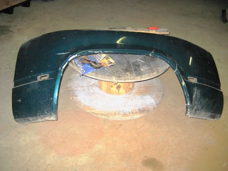

Ok i was gonna put on a fleet side bed with the dually fenders...
for rear was planning on going with a real dually rear end and springs with shackles and flip kit.
but it seems i can only find 8 lug sw and dw cab n chassis rear ends..
But cab and chassis rearends are narrower arent they??? Dont i need a regular dually rear end or what??
Wont the regular 8 lug sw still need an adapter??

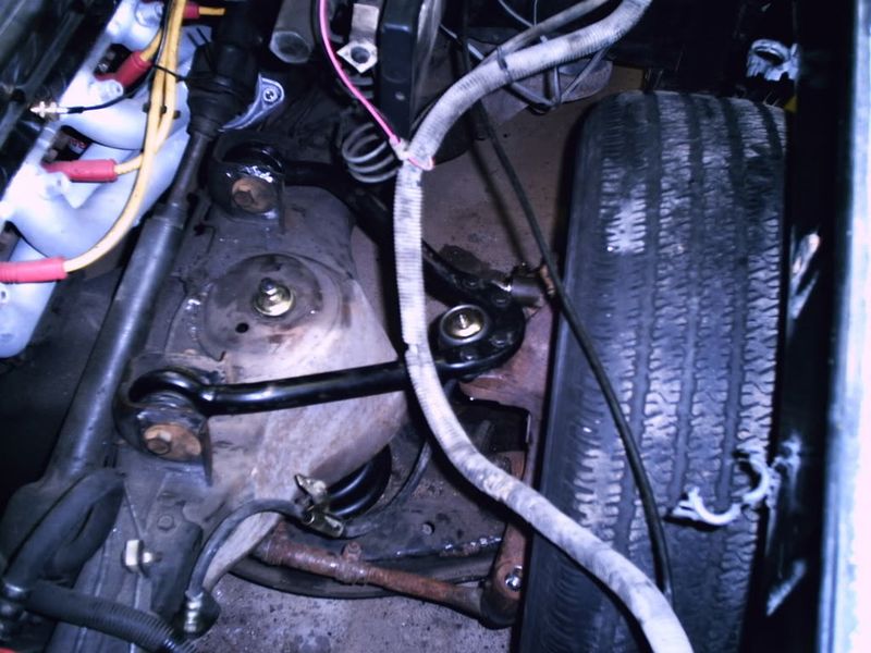

now on the front i think the lower control arms are the same from 1/2 ton to 1 ton.. I think i just need the upper control arms ,drop springs and spindles with hubs.. i was gonna probably use sw 8 lug 3/4 ton hub and a short adapter so i can try to tuck some wheel and be able to turn maybe use flares on the fenders..
How big of a notch do i need??
Will any of this work??
Also the donor trucks are all 1993 to 1998..

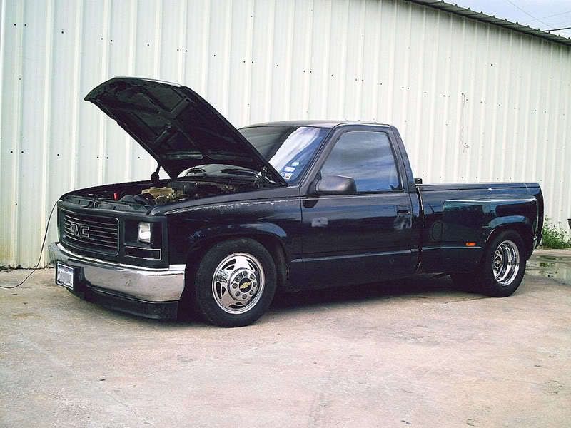

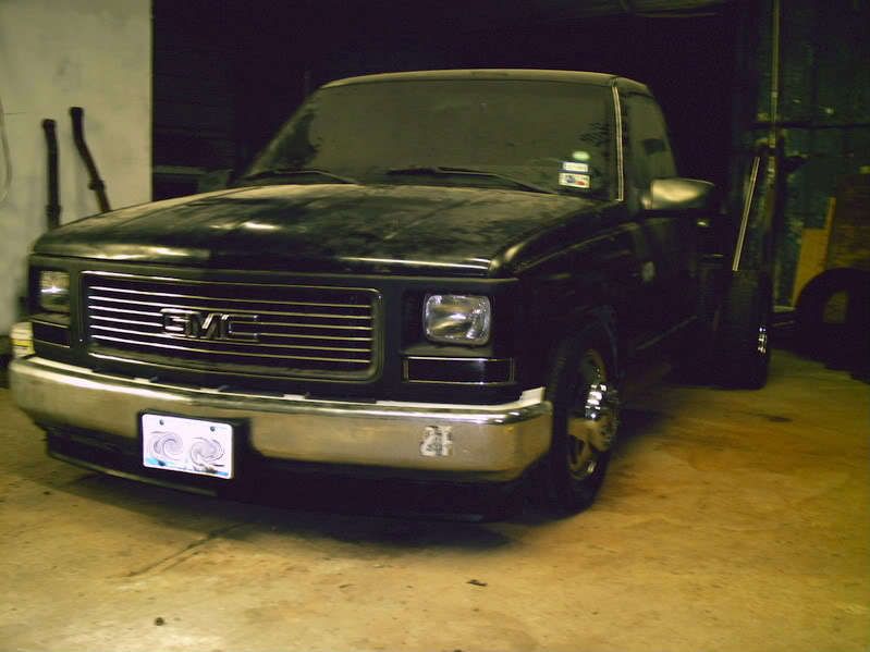

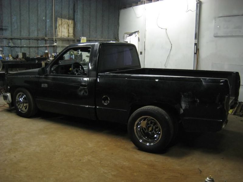

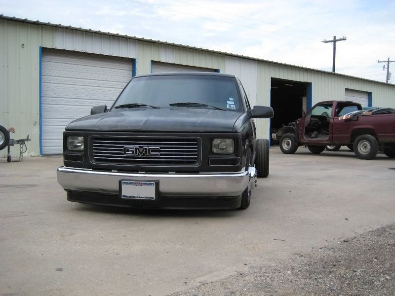

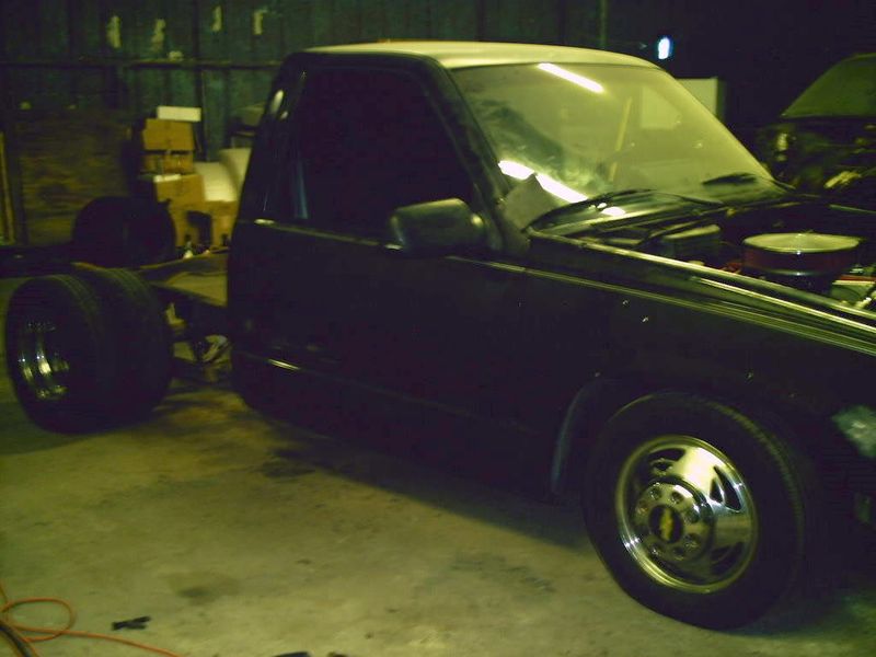

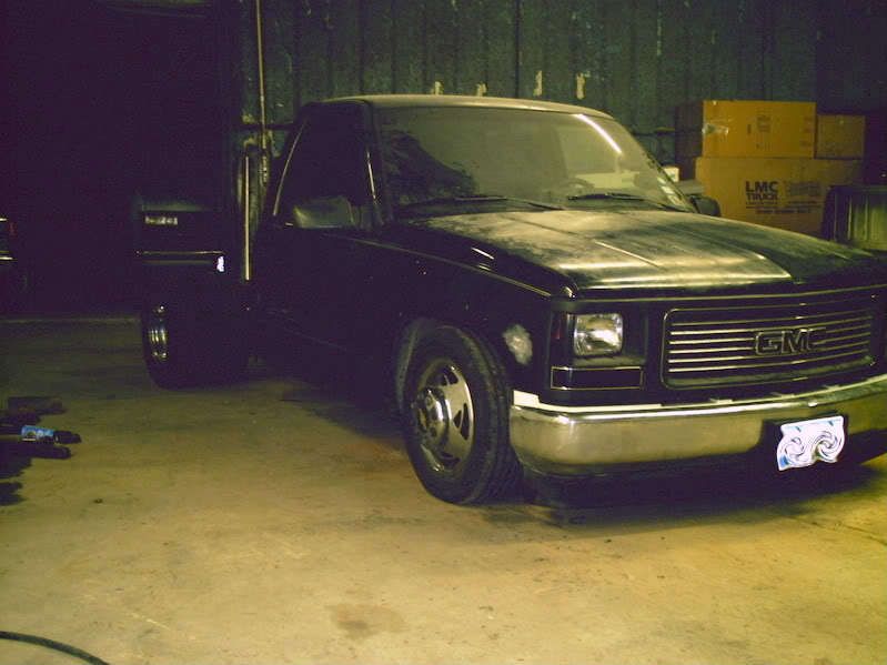

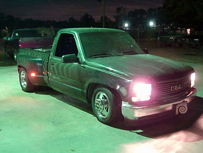

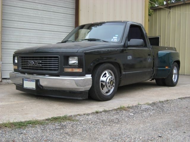

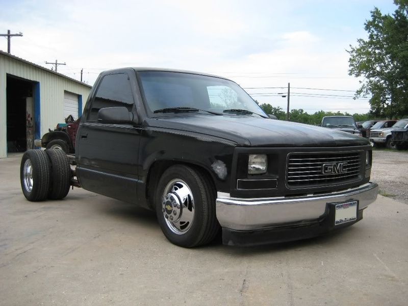

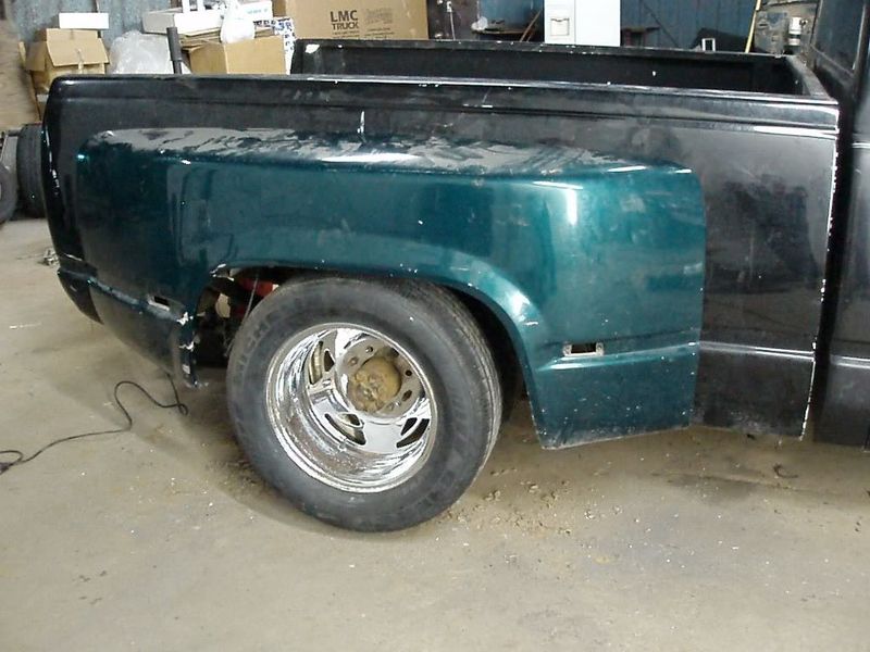

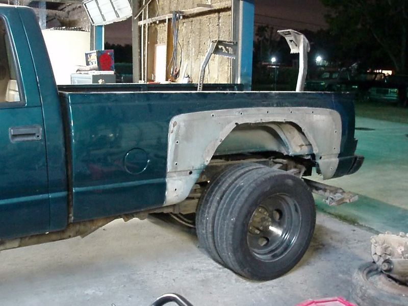

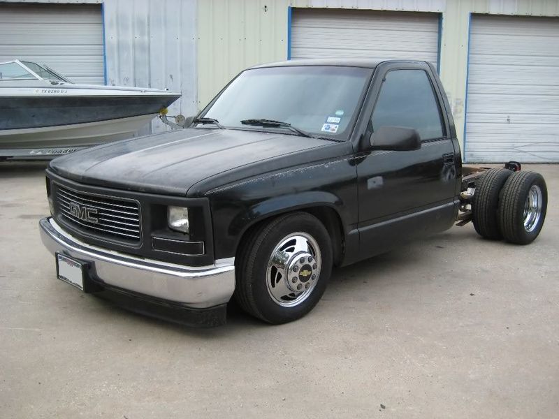

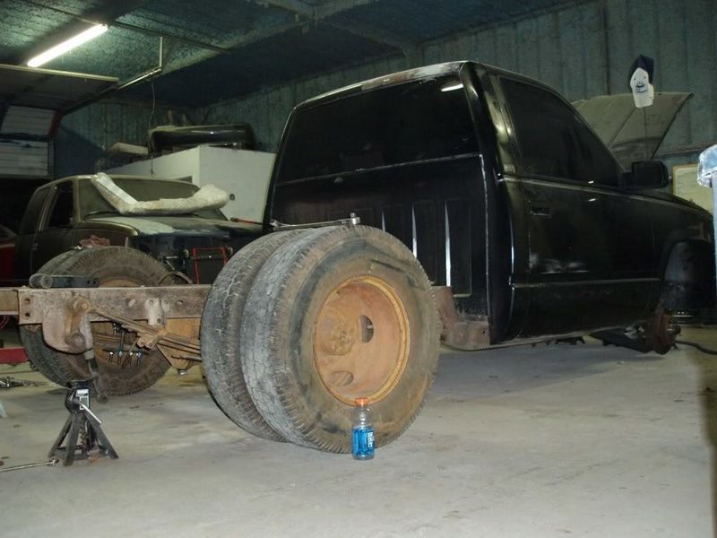

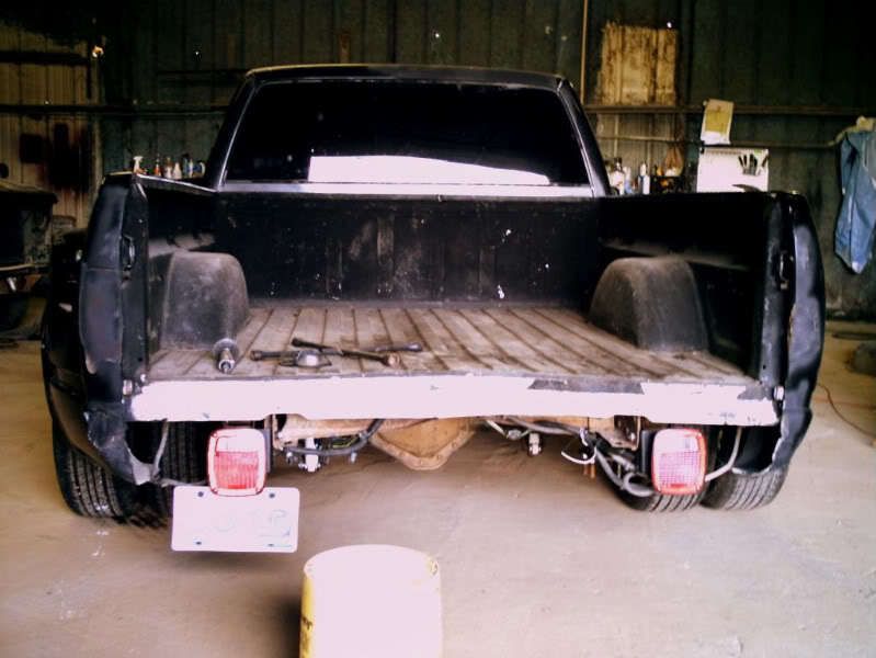

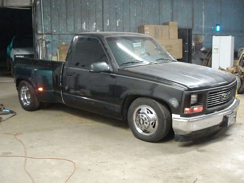

trying to go from this

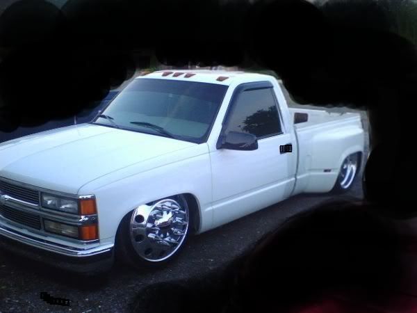

to this

Looks like the lower ball joint is the same from the 1/2 to 1 ton, according to autozone. I think your right on on the front.
You wont need much of a notch, I don't think. Probably could just go with a bolt in.

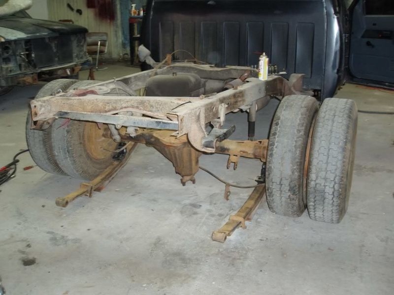

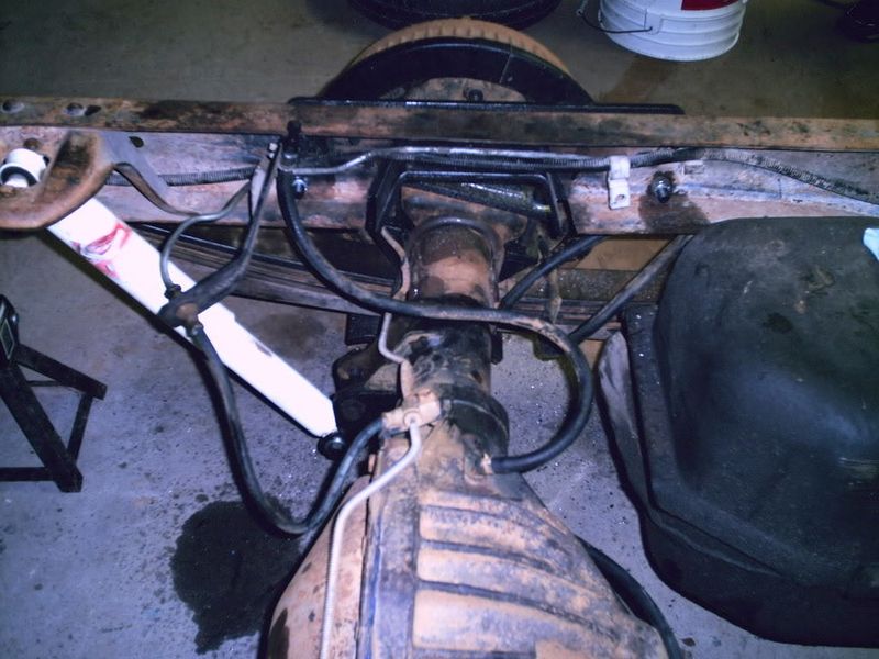

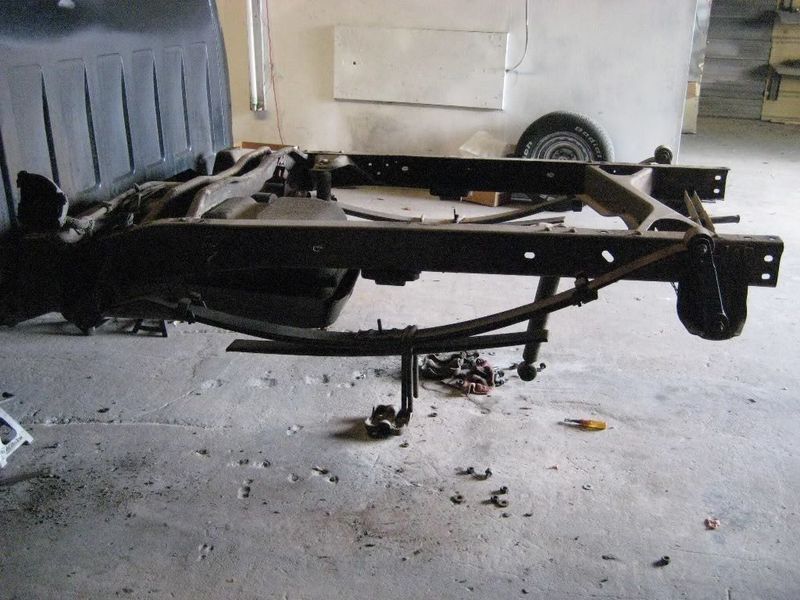

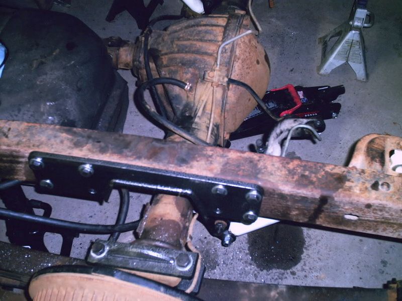

I need to check the cab and chassis rearend see if it will bolt in but people keep saying it narrower and even the spring perches are in a few inches.. i will measure it.. i just dont have a welder to be moving spring perches...
also i wasnt going to put the semi's on right away... guy i know gonna get me 4 of the 22.5 alcoa for $300.. i was gonna run stock 16" steelies till i got around to doin the body drop and getting the wheels milled... Still dont know if i should run an aluminum inside rear or steel?
huskerdually
I don't think either axle will bolt in. The swr is a little narrower than a standard dually rear axle and the c&c axle is narrower yet. The c&c axle also has an offset center section. I would think it wouldn't be too expensive to have someone move your spring perches for you.

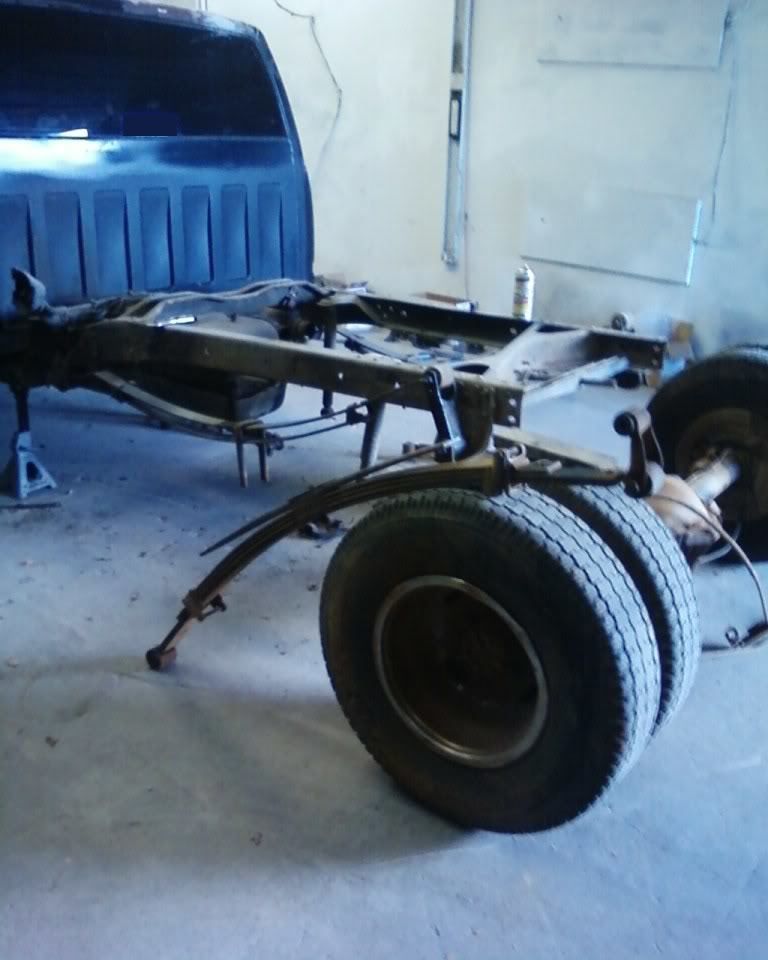

If you are going to do the dually rearend under the Stepside fenders you are definatley going to have to narrow a rearend no matter if you put stock 16" steels on it or 24" aluminums on it.
What I would do is get a C&C rearend (they are normally 44" plate to plate). I dont know how much you will have to narrow it but you may want to do it enough for the 22 or 24s the first time so you are not having to redo all of the suspension and mounting brackets. With all 4 22s or 24s on the back it adds 27.5" to the overall length of your rearend (13.75" per side) and this doesnt include having a tire on the wheels so you may want to inflate the measurement a bit. You are going to have to fab a complete backhalf anyways so you can have your mounting point as you wish and could possibly even have them adjustable for various wheel applications.
