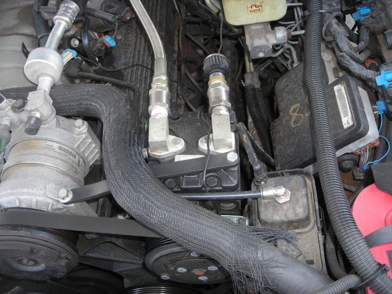

Here is my setup...its the EDC kit from SD.

Does yours get really hot? Is the kit made by airlift/easystreet? If so, they only run either a 206 or 209 compressor which is less cfm than the 210 I run. Don't know if that matters on the heat issue or not though.

...not sure what comp it is.

Yeah I am pretty sure that is the airlift kit. It uses a little less cfm compressor. The outside of them are the same, just the piston size is different. They are actually old york ac compressors. I love mine but at the moment we are having problems together, haha.
