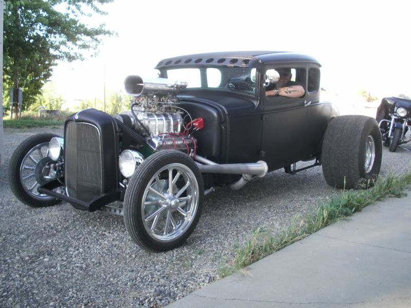

I need to see pics, my Western Chassis kit was delivered yesterday (minus the spindles or any paperwork) I am guessing that I will make my own template for cutting the frame. As for front tires I think a 235/60/16 is the shortest with an acceptable load range. I am going to keep the tall rubber on the rear for gear ratio...besides, all my hot rods run bigs an littles
onefasthoagie
ohhh thats nice.
how about some more pics of the bigrig?
