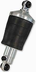

ANYBODY EVER USE THEM PROS AN CONS SHOCK WAVE 9000

What are u wanting to use them on?
They are expensive and the 9000 doesnt hold alot of weight!

I want to use them on the rear of my dually dont have a lot of room and it will kill two birds with one stone bag an shock all in one i dont tow anything with it and i already have a set from another project that was ditched <img src="{SMILIES_PATH}/icon_rolleyes.gif" alt=":roll:" title="Rolling Eyes" /><!-- s:roll: -->

I don't see a 9000 series shockwave, do you know the specs?

Only 1200 lbs at 100 psi, and only six inches of travel/lift. That's only 2400 lbs if mounted on the axle, I don't think they have enough carrying capacity even for an unloaded truck. What is your truck exactly?

well have you ever heared that song the man in black sings its a 83 long bed 1/2 ton that now has 85 cc rear and front susp 22s drop spindls bags z ed frame layin body hard think im goin with ssd 4 link and i guess bags no any body lookin for some of these i have the full rear kit
