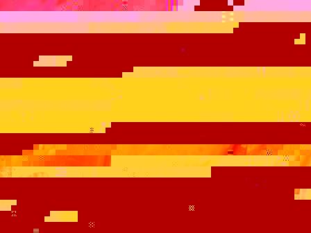

speedracer
I finally got some pics

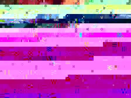

speedracer
i can't figure out how to post more than 1 pic at a time
speedracer
here is another 1
