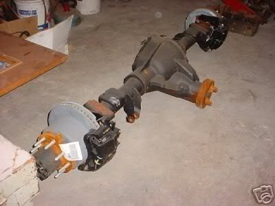

Lets have a little lesson on rear axles shall we?
Semi Floating Axle
Full Floating Axle
I know the Semi Floating pic is of a 5 lug axle but you get the idea.
Also the SF14 will have a 9.5" Ring Gear while FF14s have 10.5" Ring Gear
Semi Floating
Full Floating
Once you know what you got, get on ebay.

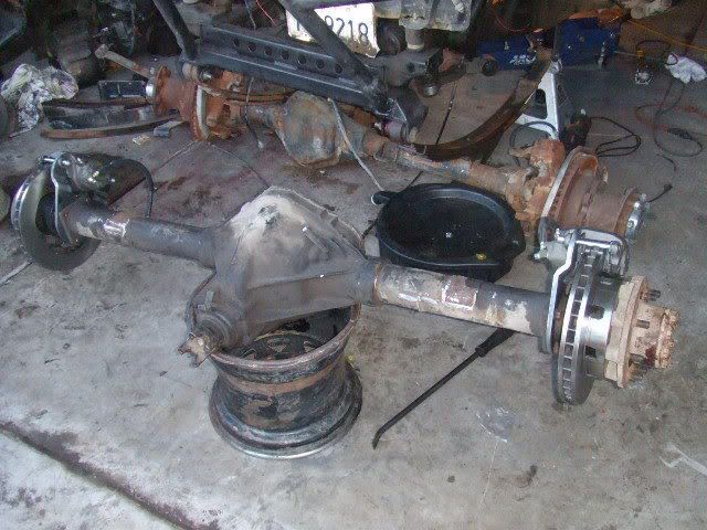

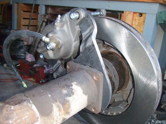

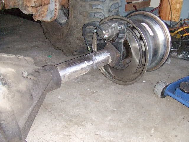

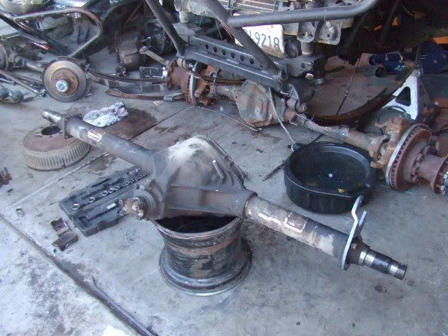

Its cake to do. I did on my full floating 14. Got the disc brackets from here
Everything else you can get from a 1978 era 3/4 ton chevy truck, or a guy on pirate sells a complete kit
This is mine and those are 15" wheels on it.
