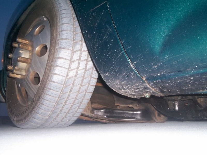

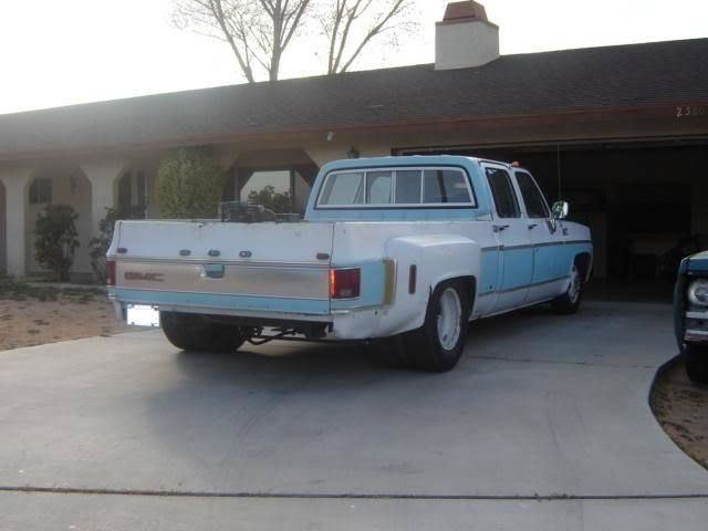

jcampbell1180's avatar

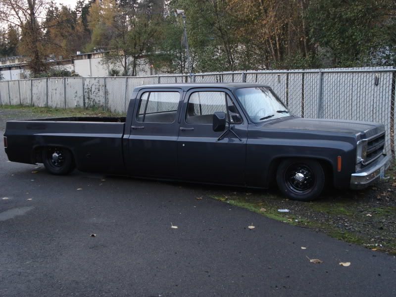

jcampbell1180
'77 GMC C30
Western Chassis 6/8-but it's more like 6/10-ish
Front:
3" Drop Spindle
3" Drop Coil
stock shocks
Rear:
Flip Kit
2" Shackle
shorter shocks (sorry, no P.N.)
Wheel/Tire Size:
16" stockers
(6) 225/75/16
The kit's pretty self-explanatory. Went on with minimal headaches. Western Chassis/Sport Truck Direct were real easy to deal with. I ended up removing the inner fenders and cutting a small hole in my bed to clear the pumpkin. I suspect if I didn't run the drop shackles, I wouldn't have had to cut the bed, but there ain't no getting around the inner fenders with this amount of drop. You're going to rub up front. A mini-tub would have been sufficient, but I opted to just yank them out entirely.
It's a real streetable drop. I use it as my daily so it get a lot of miles put on it. I haven't had any problems since I yanked the inners and cut the bed.
I'll definitely run this drop again on my next rig. Although next time, I think I'll run some helper bags as well.
*UPDATE* I raised the rear end up an inch on the shackles while I had the bed off. It kept me from having to cut a hole in my new bed. So far, so good.
Build thread
Post was last edited on Jul 08, 2009 02:47. Edited 1 time.

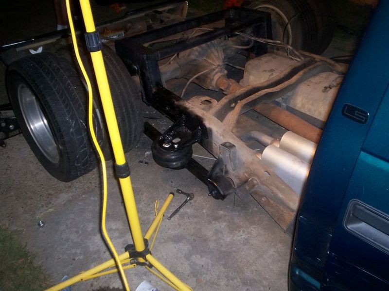

okcderek's avatar
okcderek

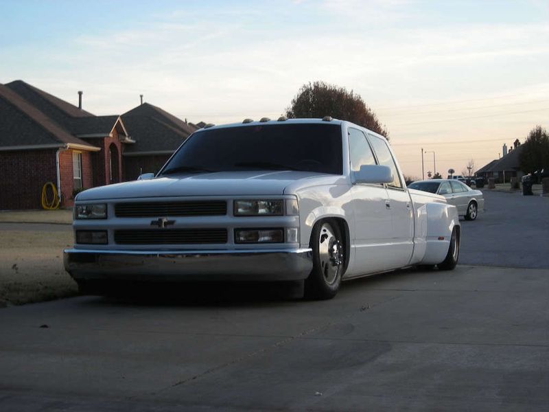

Year, Make, Model
1999 Chevy C3500
Front suspension
Belltech spindles, SlamSpecialties 8" bags,cups from Suicide Doors
Rear suspension
Parrallel 4-link, panhard, 8" Slam Specialties bags behind axel,step notch
Body drop
none
Air management
8 SMC 1/2" valves, line, fittings, AVS 9 rocker style lockable switchbox,Engine driven compressor kit, 2 Stainless 5 gallon tanks, and one 300 series nitrogen bottle for backup.
Wheel and tire size.
16s w/ 225/75/16
What you would change or do different
Switch my dump valves to GC stealth valves
Post was last edited on Dec 11, 2008 01:38. Edited 1 time.

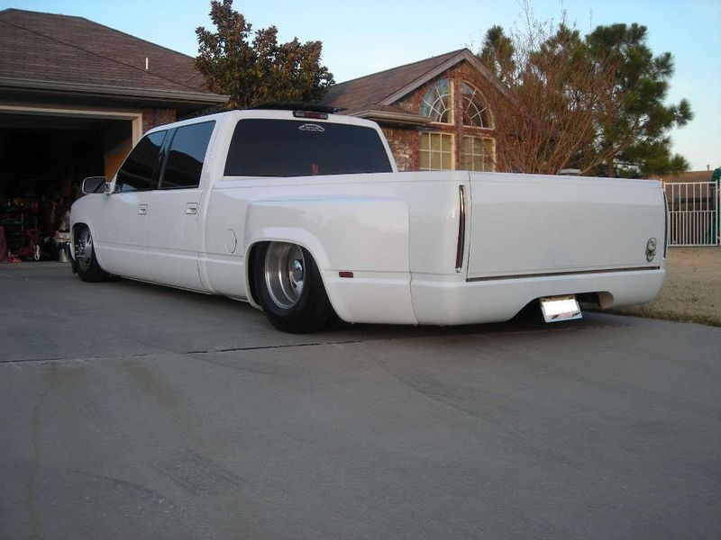

E

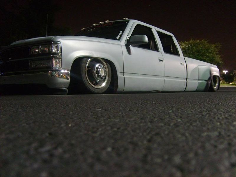

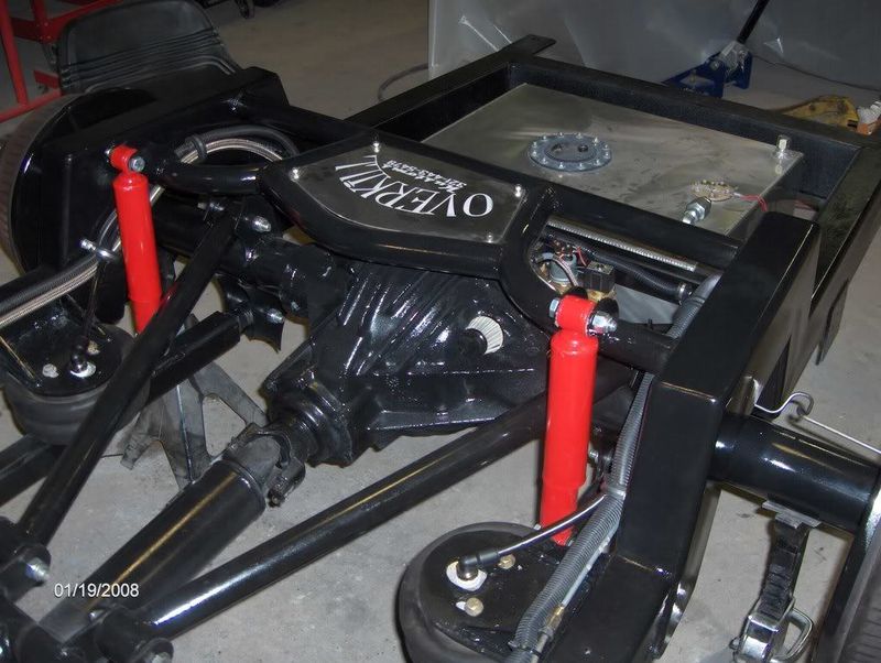

ec_dually
Year, Make, Model
2000 chevy crew cab dually
Front suspension
Chassis Tech 3 inch spindels
slam re8 bags
suicide doors cups
Rear suspension
custom made 2 link
slam re8 bags
suicide door brakets for bags on bars
custom crossbar to tie link bars together ( temp)
10 in monster notch
Body drop
no body drop planned
Air management
6 GE XTREEM 1/2 VALVES
1/2 inch line
2 switches
bigg ass nitrogen tank
16 inch aloca small holes
225/60/16
List if inside duals are different
same size
sand down and smooth out and reapaint,
22" semi's
shaved door handles
suicide back doors
sheet metal bed
redo whole interior
removed tie bar on links and add Watts Link
DRAG DRAG DRAG DRAG DRAG DRAG DRAG DRAG...

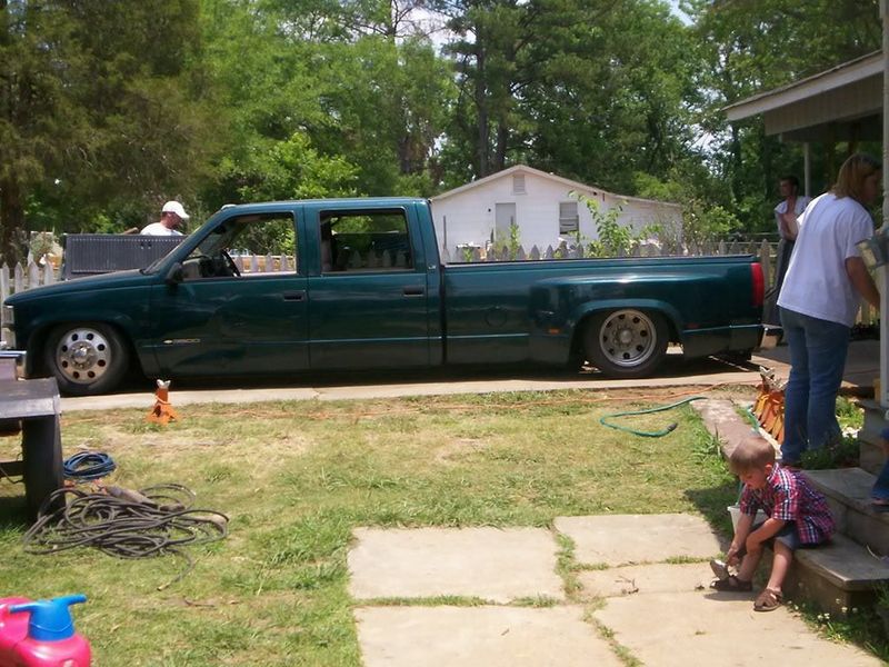

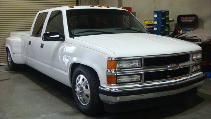

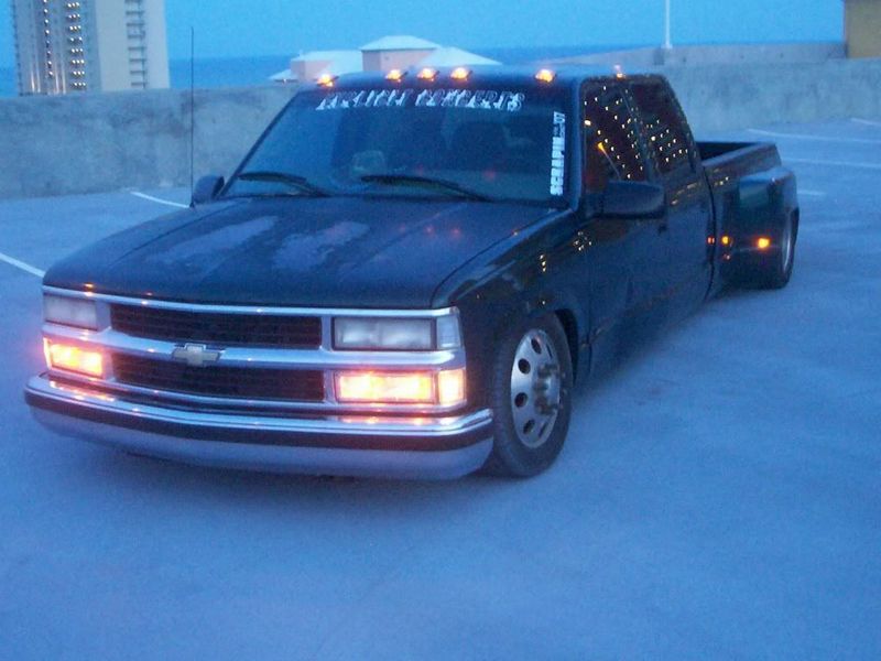

rhmdually
Year, Make, Model
1993 chevy dually
Front suspension
stock arms, belltech spindles, re-7 bags, custom cups
Rear suspension
triangulated 4 link, bag on bar, re-8s, 6 inch or so notch
Body drop
4 inch stock floor
Air management
8 smc 3/8ths valves, 1/2inch line, 8 gallon tank, dc5000 compressor
19s with a 235/35/r19 16 inners, cant remember the size
already redid it to fix everything i would do different lol

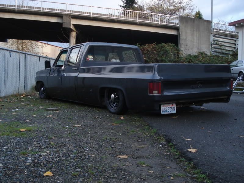

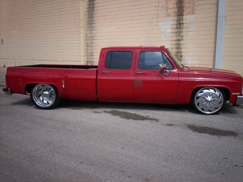

bondo's avatar

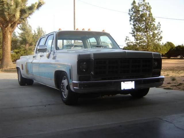

bondo
1975 Gmc C-20
still 8 lug
up front- stock arms, aim spindles, extensive cups
rear- 8 inch notch, suicide triangulated 4-link, djm shock all around
dominator 8 bags 2600's
2 480 compressors
2 5 gallon tanks
1/2 dot line, soon to be copper
4 1/2 valves
16 inch steel black rims
3 inch lug nuts
205 60 16's
lays frame hard

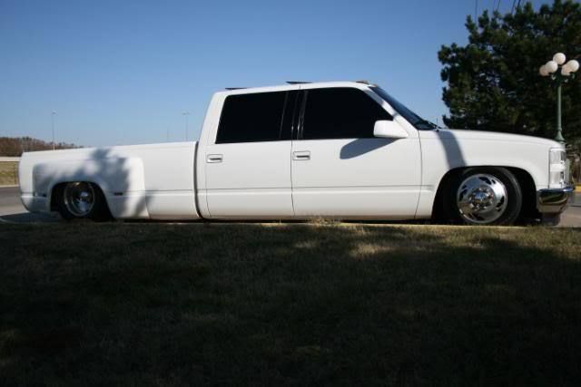

jcampbell1180
Bumpage...

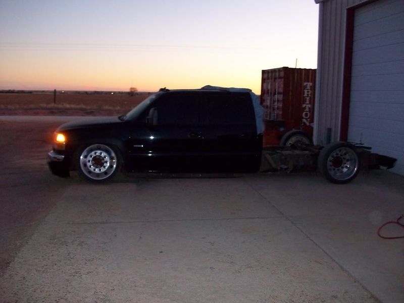

low95xlt
Year, Make, Model
1998 Gmc 3500 Crewcab Longbed Nnon dually
Engine
7.4Liter 454c.i. kept a/c
Front suspension
DJM spindles KustomWorks Upper/Lower A Arms
Slam Specialties RE-7's up front and Re-7s in the rear
Rear suspension
Bag over axle
4linked
Notch intergrated into stockfloored frame
Stockfloored bodydrop
Air management
8 GC extremes 1/2 250 PSI no hoppin here
1/2 line
12 gallon tank mounted in rear
oasis hp1000 compressor
22x9 Panther Juice 8's
Nexen 245 40 22 tires
Fuel cell from Guilty By desgins(aka Kyle)
Not sure yet
Stocker
Shocker
