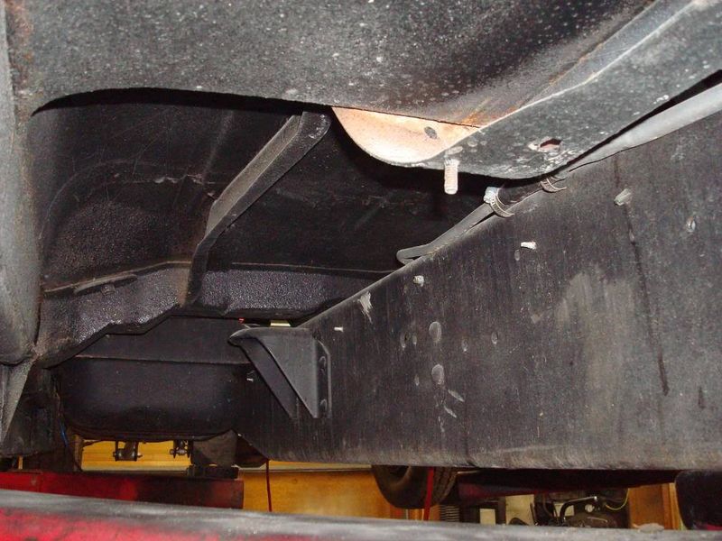

Prob been asked a 100 times but cant seem to find it. I have an 89 Squarebody right now its bagged with re-7s up front. I recessed the bag in the lower arm 2" but my frame is about 2" from the ground. Do i just need to Z it 2"? If i do that do i need to cut some of the tranny tunnel out in the cab? How much? Do i need to raise the tranny and the carrier bearing up also? If anyone has some pics that would be great. Sorry for the book just want to make sure im doing it right.

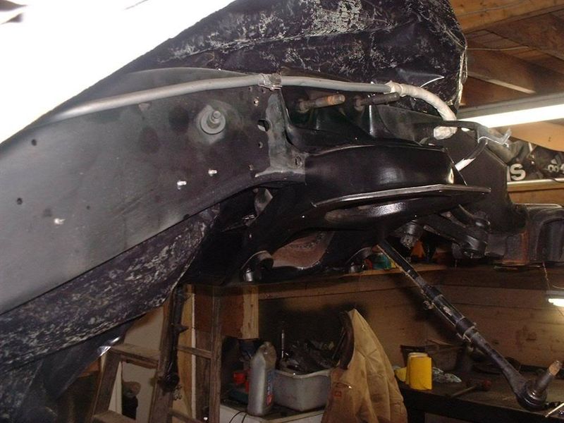

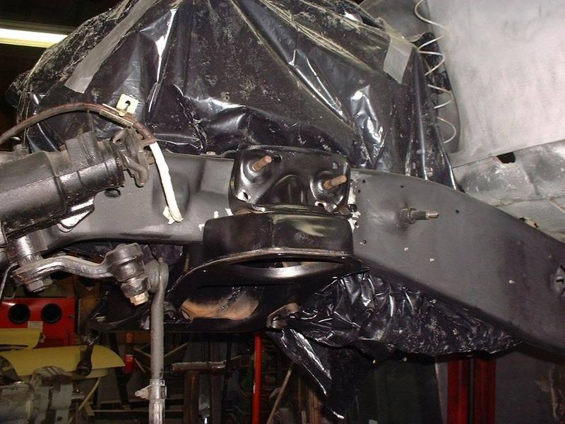

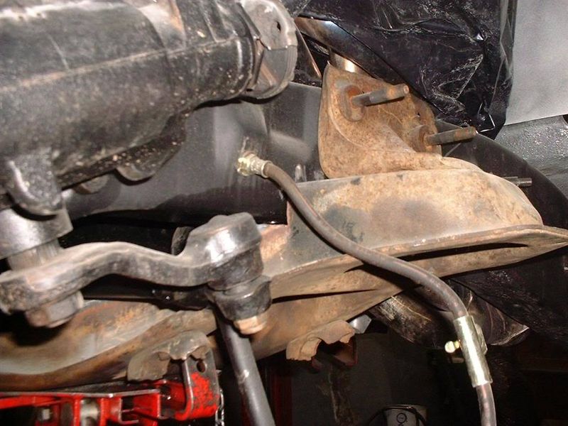

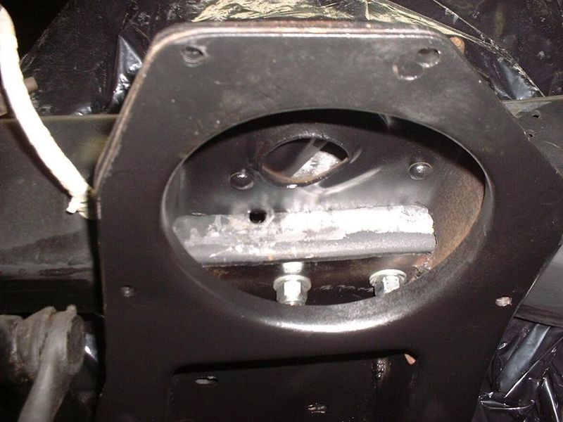

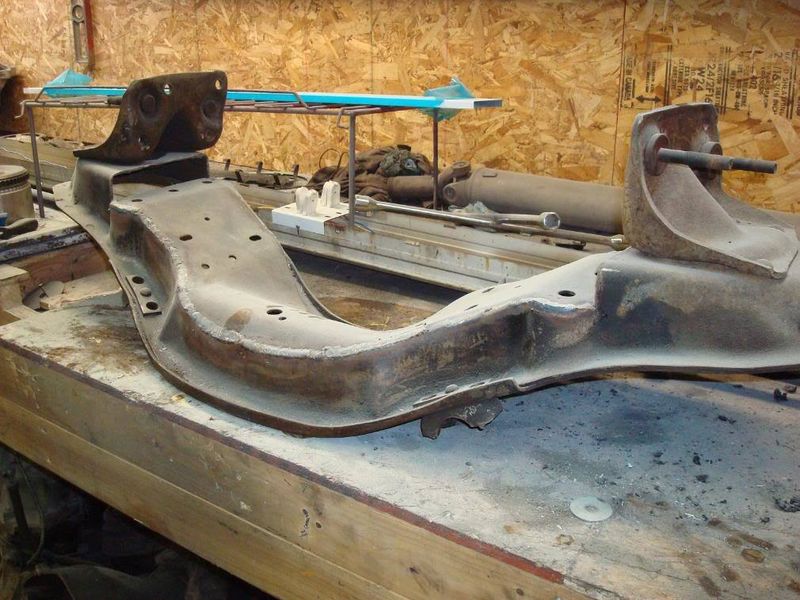

you should be laying out do you have spendels

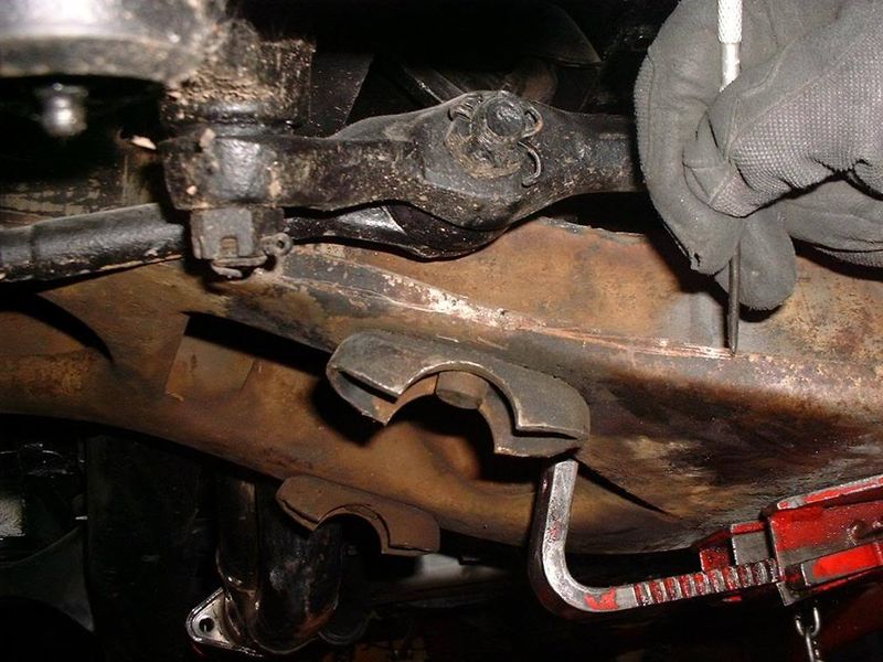

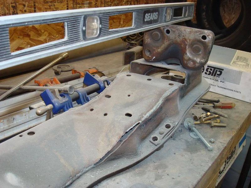

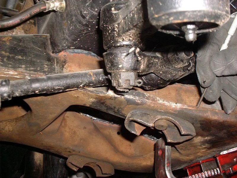

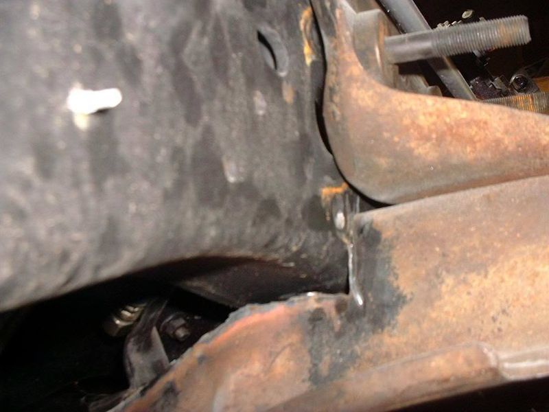

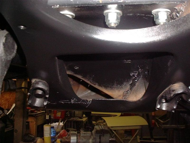

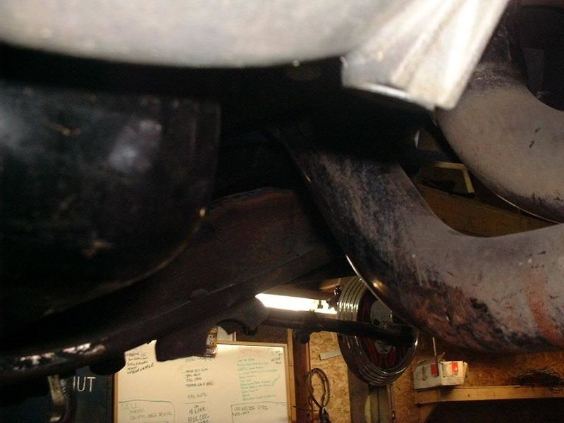

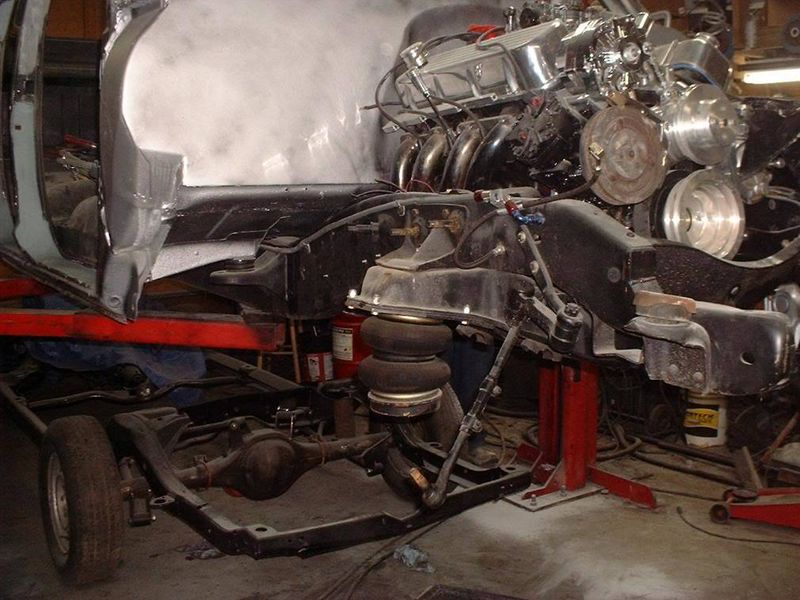

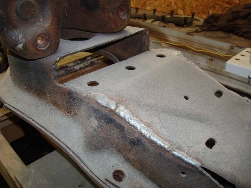

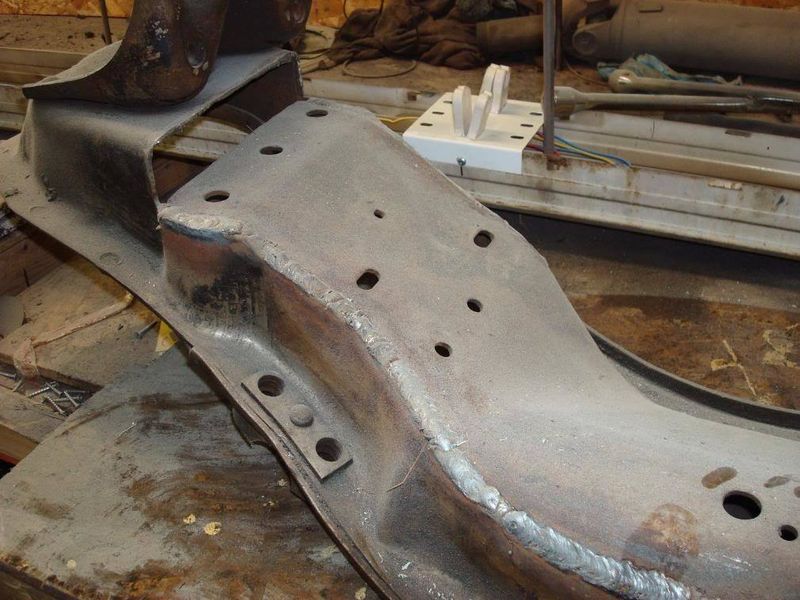

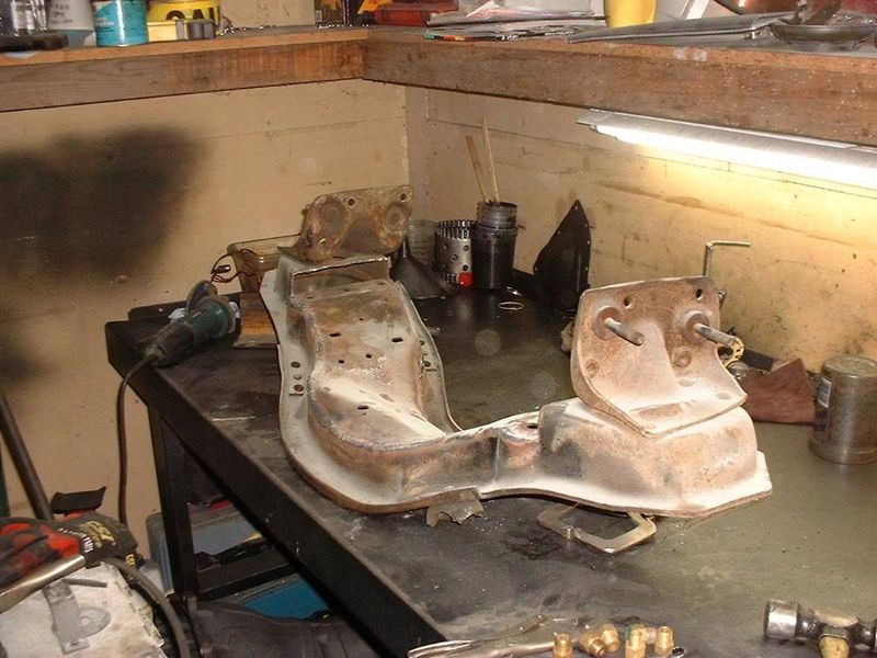

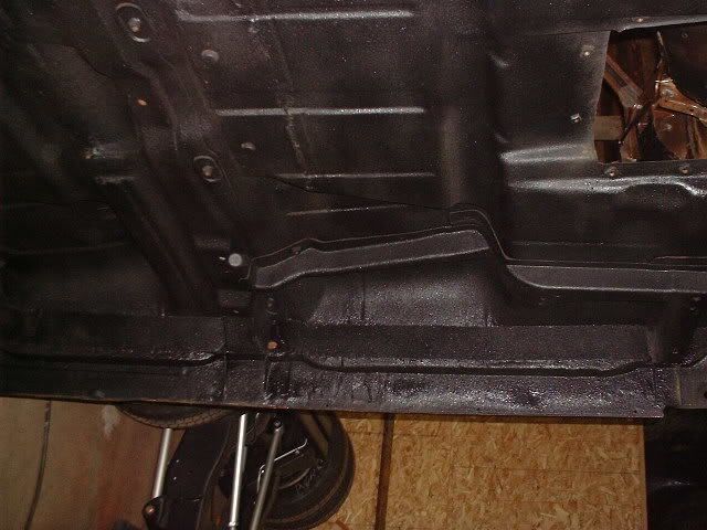

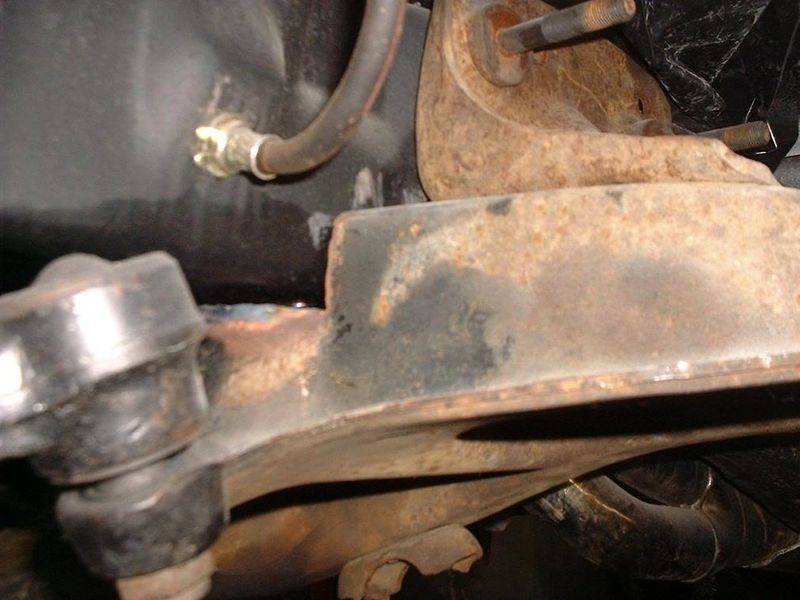

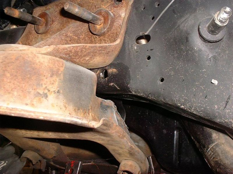

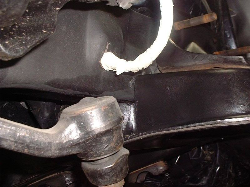

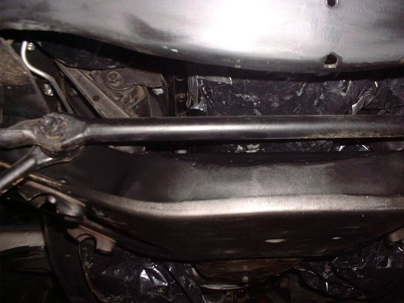

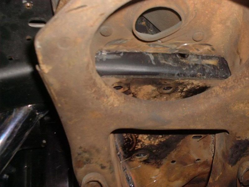

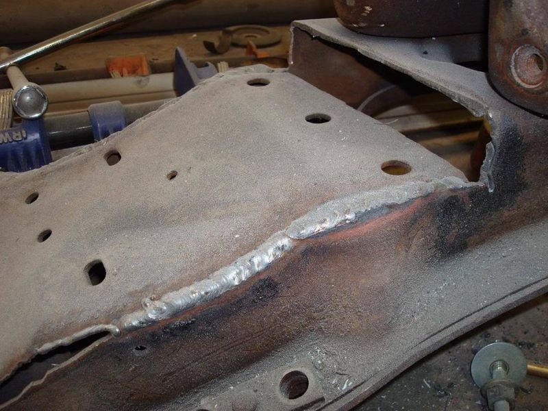

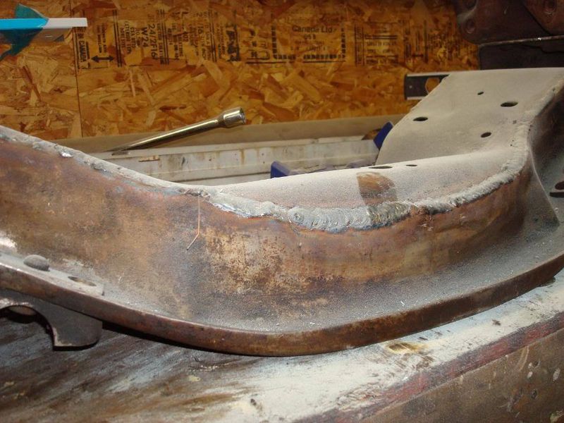

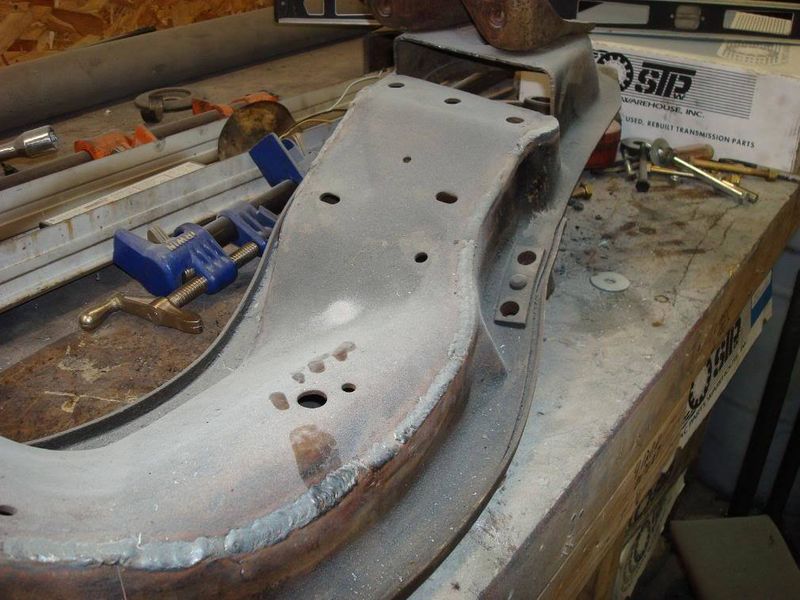

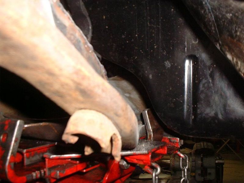

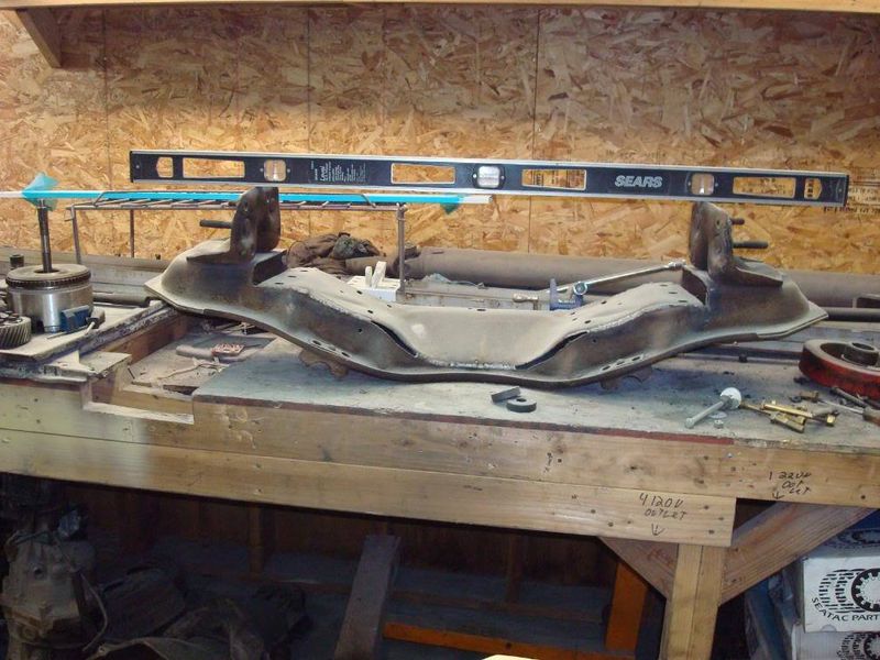

i sectioned my x member hers pics
speedracer
Ya i have 2" drop spindles with 22" semi wheels. How much did you cut out looks like about 2". Did you have to pull the motor to to do it. Also did you have to raise the tranny tunnel? thanks for the pics
skidrow
nope i didnt have to pull moter just unboult it ware it hooks up to the x mimber and no i did nit have to mess with the tunnel
i acualy lowerd mine if you go to my photobucket you will see i have like 2000 pic of the biuld

I have spindles ,22"s...u shouldnt have to Z anything?

Shouldn't have to z a 1 ton.

if you arent laying on the crossmember than zing it isnt your answer
huskerdually
Ya you need to figure out what is holding your truck up.

your lower control arms should hitting the ground first.
speedracer
My lower arms are on the ground but the frame isnt. Thats why i thought i should Z it so if drag it sometimes i would rather drag the frame than drag thru my lower arm. I might just section the crossmember a little it doesnt look that hard to do.
